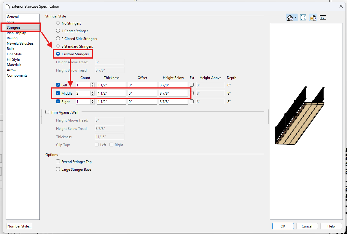

RicBrown Posted January 7 Share Posted January 7 I am designing a deck with stairs and I need to add additional stringers. Is it possible to add additional stringers to stairs as our code here requires the stringers be 12" on center. Link to comment Share on other sites More sharing options...
JonathanK Posted January 7 Share Posted January 7 Open the stairs, go to Stringers tab on left, then click on "Custom Stringers". For the middle section, change the count to 2...or whatever you need to get approx. 12" OC. 1 1 Link to comment Share on other sites More sharing options...
