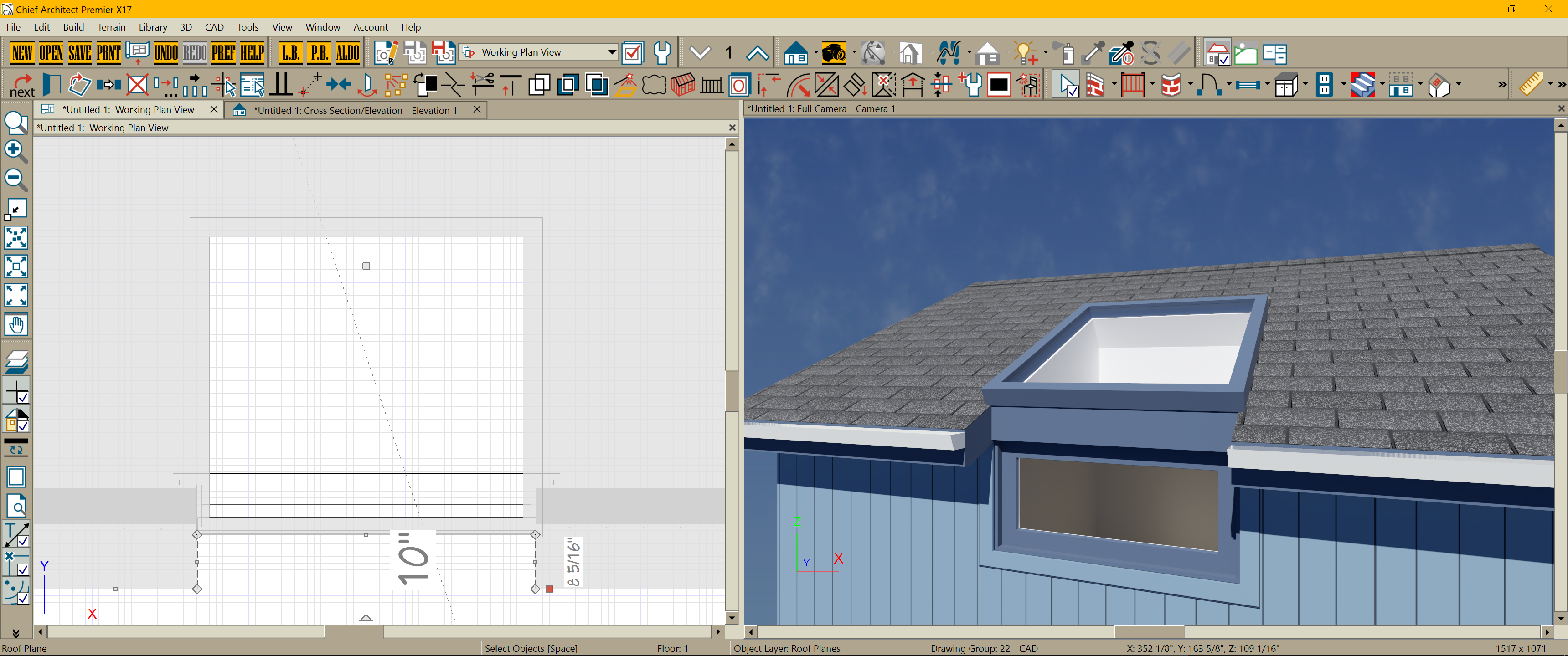

Costyler Posted December 14, 2025 Share Posted December 14, 2025 Link to comment Share on other sites More sharing options...
Rich_Winsor Posted December 15, 2025 Share Posted December 15, 2025 For more response this question is best posted in the General Q & A Forum. That being said you can get what you want by notching the roof plane back to the wall surface where the window will be. Install the skylight into the roof plane and the window into the wall plane and with a little futzing around you can get them to work together. Link to comment Share on other sites More sharing options...
