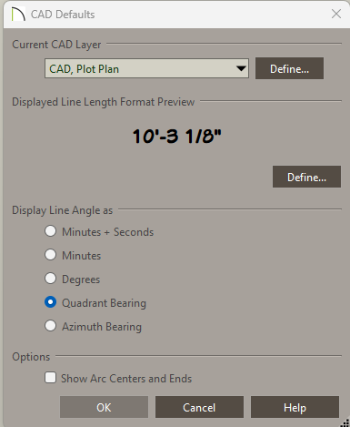

Hilltopvince Posted November 15 Share Posted November 15 I am using X14. After adjusting my terrain perimeter to my lot boundaries, I placed the north pointer and positioned it to the correct angle. In the line specification dialog I have the line style set to display both line length and show all angles. The line length is correctly displayed, however the angles still remain at 0 deg / 90 deg / 180 / and 90 deg. When I rotate the north pointer the angles bearing locations on the line are not changed. The plot plan text definition is set to rotate with the plan. I'm wondering if I'm missing something that links the north pointer to the poly lines. I haven't been able to find a lot of info on the topic. Any suggestions would be appreciated. Untitled 1.zip Link to comment Share on other sites More sharing options...
Renerabbitt Posted November 15 Share Posted November 15 1 hour ago, Hilltopvince said: Any suggestions would be appreciated. Edit/Default Settings/CAD/General CAD/ set to "Quadrant Bearing" 1 Link to comment Share on other sites More sharing options...
