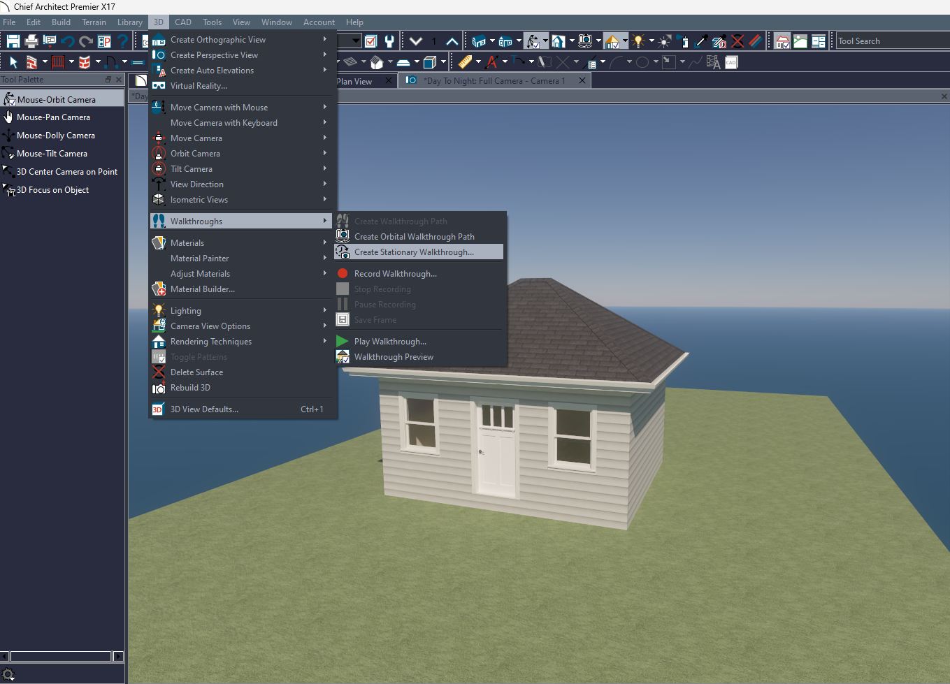

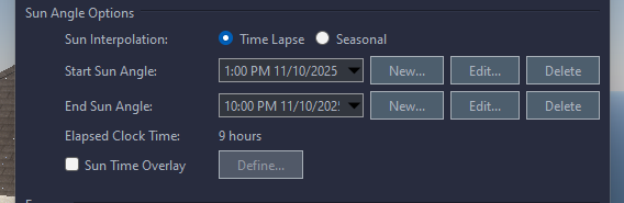

Chief_Trent Posted November 10, 2025 Share Posted November 10, 2025 Hi Rene, You can do this with 3D > Walkthroughs > Create Stationary Walkthrough and then set up sun angles under Sun Angle Options to get the start and end time you're looking for. Link to comment Share on other sites More sharing options...
Renerabbitt Posted November 10, 2025 Author Share Posted November 10, 2025 6 minutes ago, Chief_Trent said: You can do this with 3D > Walkthroughs > Create Stationary Walkthrough ive done this but I dont seem to be getting a night time look at the end. Ill try again Link to comment Share on other sites More sharing options...

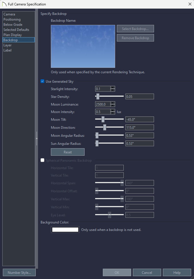

Chief_Trent Posted November 11, 2025 Share Posted November 11, 2025 2 hours ago, Renerabbitt said: ive done this but I dont seem to be getting a night time look at the end. Ill try again Ah, you probably need to enable the generated sky instead of using a backdrop image. You can open the Full Camera Specification dialog via Edit Active View and go to the Backdrop panel and check Use Generated Sky. Link to comment Share on other sites More sharing options...
