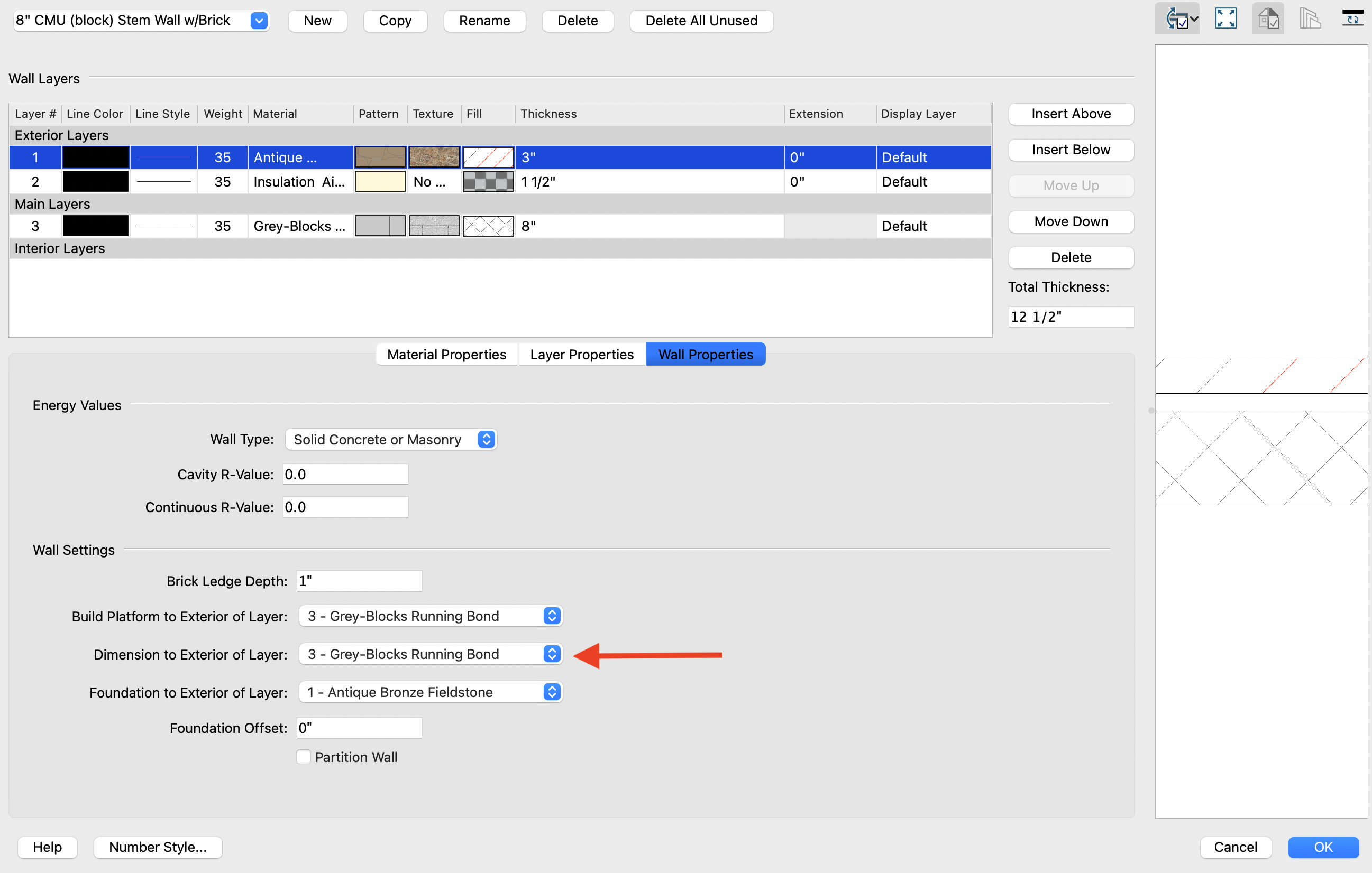

StephenGreene Posted October 27, 2025 Share Posted October 27, 2025 i think this is what you're looking for. under the wall DBX, you can choose which layer of the wall you want dimensioned. Link to comment Share on other sites More sharing options...
Jakereinhardt55 Posted October 27, 2025 Author Share Posted October 27, 2025 28 minutes ago, StephenGreene said: i think this is what you're looking for. under the wall DBX, you can choose which layer of the wall you want dimensioned. That’s kind of what I’m asking. I was hoping I could get the program to do this automatically with a concrete wall so I could control brick ledge height but it looks like I may need to create special wall types for this situation. Link to comment Share on other sites More sharing options...
Solution JiAngelo Posted October 27, 2025 Solution Share Posted October 27, 2025 (edited) Use a pony wall. Specify depth of top 4" concrete wall over a lower 8" concrete wall to establish brick ledge height. Use a different pattern for the lower 8" concrete wall used as brickledge and display both walls. And keep same pattern for 4" wall as you have for full height non-brickledge 8" walls. Edited October 27, 2025 by JiAngelo Spelling Link to comment Share on other sites More sharing options...
Jakereinhardt55 Posted October 27, 2025 Author Share Posted October 27, 2025 1 hour ago, JiAngelo said: Use a pony wall. Specify depth of top 4" concrete wall over a lower 8" concrete wall to establish brick ledge height. Use a different pattern for the lower 8" concrete wall used as brickledge and display both walls. And keep same pattern for 4" wall as you have for full height non-brickledge 8" walls. Thank you Link to comment Share on other sites More sharing options...
