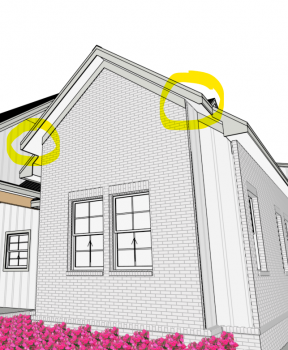

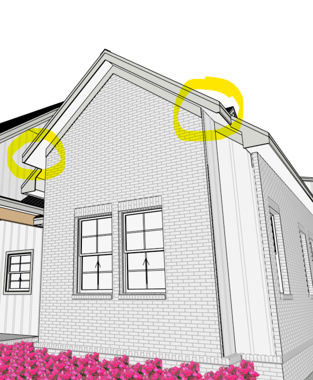

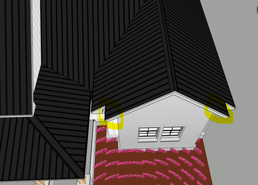

winterdd Posted October 21, 2025 Share Posted October 21, 2025 Hey guys, I can't get these eaves to box. Would this be because of un-joined roof planes somewhere or the wall offsets? (example below) Link to comment Share on other sites More sharing options...

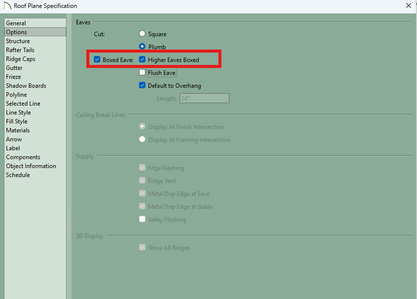

Solution tundra_dweller Posted October 21, 2025 Solution Share Posted October 21, 2025 First thing is to make sure that you have "Higher Eaves Boxed" checked in your roof options. If you do have that option checked then it could be any of those other things you listed, in my experience. 1 Link to comment Share on other sites More sharing options...
winterdd Posted October 21, 2025 Author Share Posted October 21, 2025 Thanks man, It's always something so simple. 1 Link to comment Share on other sites More sharing options...
