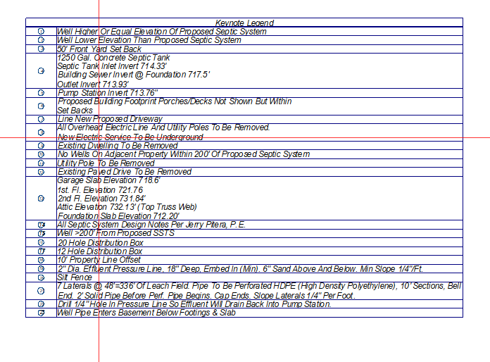

Ed_Orum Posted October 21, 2025 Share Posted October 21, 2025 When I generate the note schedule, the note text is the correct size, but the note label is very small as you can see from the screenshot. How do I get them both to be the same height? Thanks in advance, Lane Link to comment Share on other sites More sharing options...
richoffan Posted October 21, 2025 Share Posted October 21, 2025 Lane, Open the entire schedule dbx. In Labels, there is a Callout Layer. You can use objects' Label Layer (say door labels) or the Schedule Layer or Custom. The text style in that layer controls the size of the label in the schedule Link to comment Share on other sites More sharing options...
