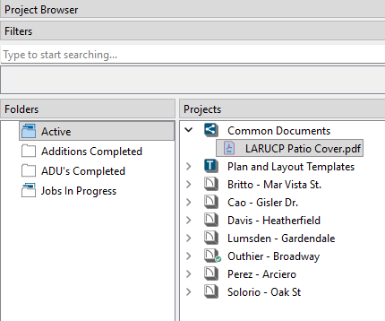

builtright3 Posted October 10 Share Posted October 10 Hey Guy's and Gal's, I just started using the project browser (manager) in X17. I confused in the purpose of what the Common Documents are used for. Is it only just a storage folder for documents or is there more to it than than? The reason for my question is that when I bring PDF's into my plan or layout, I was trying to figure out where the pdf would be stored in the project browser. Any input would be helpful and any other dialog for using the project management system. I watched the video and read what I could in the help section. I think I understand a lot of it but would like to know more from others that are using it. Thank You This is the way I have mine setup so far. Note: When i click on any of the folders on the let the common documents and plan and layout templates dont show up. Im sure that is typical. Not sure. Link to comment Share on other sites More sharing options...
JacobCarter Posted October 10 Share Posted October 10 Hello! The design intent for the Common Documents location is to be a place you can put plans that you want to link to from more than one Project. Note that typically plans and layouts can only be linked together if they exist in the same Project. We currently do not have the ability to link to PDF's that are stored in the project browser, instead requiring that the PDF be moved to the asset browser for usage (right click the PDF in the project browser and select "Move to Assets"). We are aware this is a bit of a pain point and are looking at ways to improve it moving forward. For now we encourage putting any non plan/layout files that do not need to be linked to, but are useful to have together with the plans/layouts, into the Project. As for the folders on the left, clicking one of them will filter your project browser to only show the Projects that are associated with that folder. The "Common Documents" and "Plan and Layout Templates" are not currently able to be associated with those folders. Let us know if that is something you think would be useful to your workflow! Note that some users prefer to not see the "Common Documents" or "Plan and Layout Templates" at all, which can be controlled in the preferences dialog under "Project Browser". See the checkbox: "Show Default Categories". Link to comment Share on other sites More sharing options...
