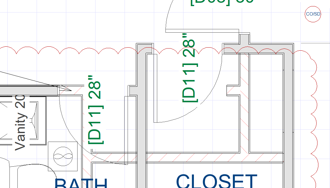

SHCanada2 Posted September 30 Share Posted September 30 (edited) Please move this to Q&A. Two ways I do it. If it is just a couple walls, I just use a hatched polyline that represents the wall to be demolioshed. Sophisticated way. Once you draw the existing plan, save it, then duplicate it(proposed plan). Then you create a reference view that shows both plans. you can then create something like this: CA has some videos on it: Using the Reference Display - Video | Chief Architect you can also search the forum for reference display Edited September 30 by SHCanada2 Link to comment Share on other sites More sharing options...
