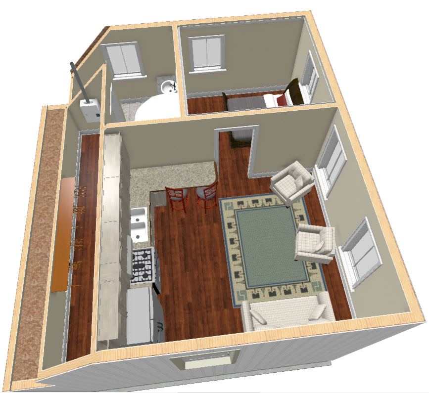

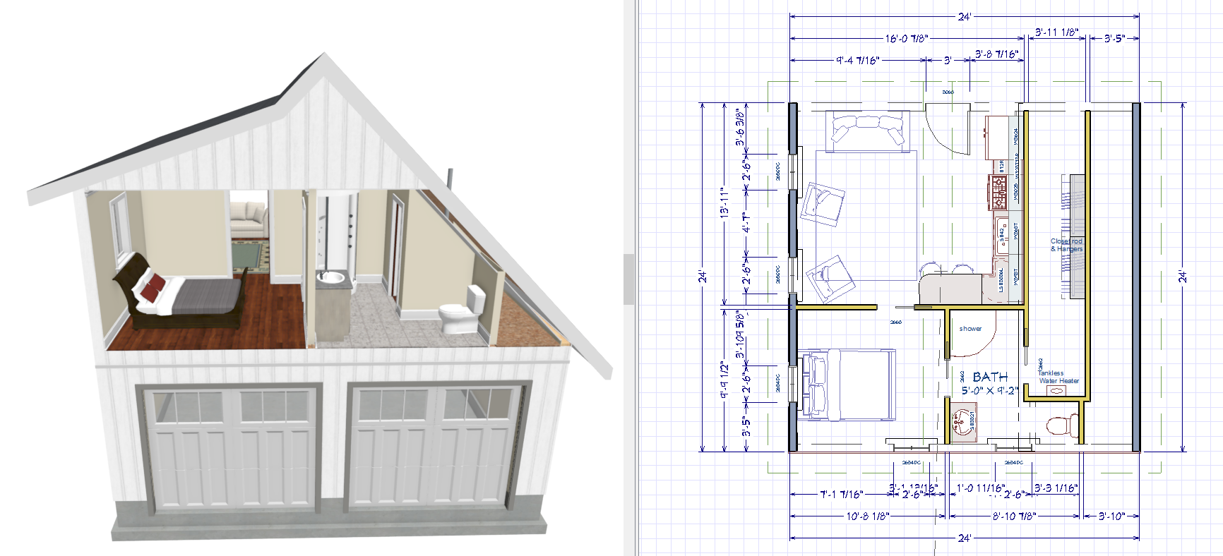

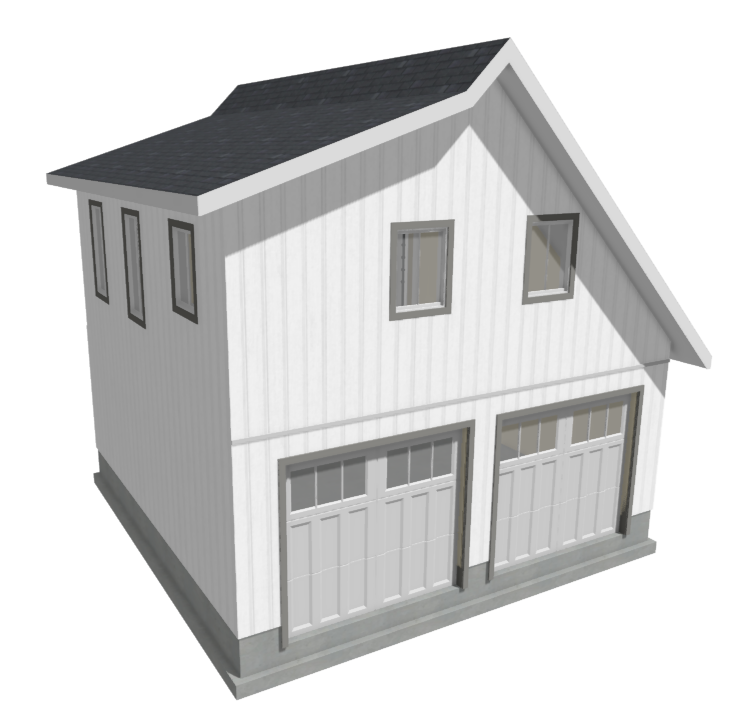

Jo_Ann Posted September 18, 2025 Share Posted September 18, 2025 I couldn't resist this plan. I think dormer framing would take up precious floor space, so I would add it as a regular "room", and then add the false soffit/fascia, so it still has the "dormer" look. Link to comment Share on other sites More sharing options...
Solution Jo_Ann Posted September 18, 2025 Solution Share Posted September 18, 2025 I wouldn't waste that precious attic space,either. Link to comment Share on other sites More sharing options...

Jo_Ann Posted September 18, 2025 Share Posted September 18, 2025 Glad you liked it! I wouldn't advocate a 2 story exterior flight of stairs for senior citizens, either. Link to comment Share on other sites More sharing options...
Jo_Ann Posted September 18, 2025 Share Posted September 18, 2025 Link to comment Share on other sites More sharing options...
decorators3 Posted September 18, 2025 Author Share Posted September 18, 2025 Yes I hear you ,, another item to discuss with the client. Jo_ann - send along monies I owe you.. Again Thanks a heap!!. Link to comment Share on other sites More sharing options...
Jo_Ann Posted September 18, 2025 Share Posted September 18, 2025 The floor plan image is easy to replicate, so you should add your own touch to it. 1 Link to comment Share on other sites More sharing options...
