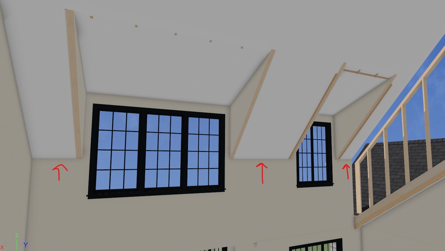

NewUserSargent Posted September 9, 2025 Share Posted September 9, 2025 Hello all, This is my first time using Chief Architect and ive gotten comfortable enough to build a house out in the app but there are a few things that are causing me issues. One is the dormers i have now. I have been working for about 2 days now trying to get them correct but just cant seem to get them right. Another is the random framing members that are appearing throughout the house. Im not sure why they are showing up. The issue im having with the dormers are the side walls of the dormer and making them not jut all the way down to the floor. Any help would be appreciated. Feel free to message me with questions or anything else. Thank you, Hunter Sargent_auto_save.zip SARGENT_HOUSE_FINAL_V5.2_03.28.2025.pdf Link to comment Share on other sites More sharing options...
Mark3D Posted September 10, 2025 Share Posted September 10, 2025 See if that helps With those dormer side walls set to roof cuts bottom and framing stickout turn of there layers in camera views and i manualy moved top and bottom height dormer face wall so may affect framing but was only way i could figure to look good Sargent_auto_save mark edit.zip 1 Link to comment Share on other sites More sharing options...
NewUserSargent Posted September 10, 2025 Author Share Posted September 10, 2025 14 minutes ago, Mark3D said: See if that helps With those dormer side walls set to roof cuts bottom and framing stickout turn of there layers in camera views and i manualy moved top and bottom height dormer face wall so may affect framing but was only way i could figure to look good Sargent_auto_save mark edit.zip 1.65 MB · 0 downloads Mark you are the man. I have only posted on this forum twice but both times you have been the one to actually help me out. You helped me with my weird roof and now with this. Thank you, I really appreciate it. Do you have a Venmo or Cash app or something? or do you provide services for pay? I might have more soon that I would be more than happy to pay for. Link to comment Share on other sites More sharing options...
