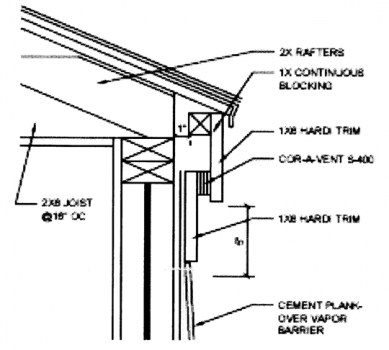

Jonathan3891 Posted September 5, 2025 Share Posted September 5, 2025 (edited) Is it possible use frieze vents instead of soffits in Chief? Here is a detail of what it looks like. Sorry the picture is a bit blurry. Edited September 5, 2025 by Jonathan3891 Link to comment Share on other sites More sharing options...
PitMan71 Posted September 5, 2025 Share Posted September 5, 2025 Hmmm.... I know that you can adjust the thickness of your soffits. Seems like if you adjusted the soffit thickness to say 1" and then reduced your overhang it might look something like this. Then I would adjust the vertical offset of the frieze the thickness of your soffit. Then lastly change the material of your soffit to what you want. Anyway, some things to try. You might be surprised. Link to comment Share on other sites More sharing options...
