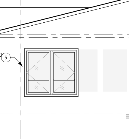

Milima Posted August 29, 2025 Share Posted August 29, 2025 I am still struggling to find out (after watching all available videos on line) how to place a lite at 1'8" from bottom. This is a double casement window 5'4" x 4'8" and it is not fixed on the bottom. Easy enough to place a lite and it falls in the center of the window pane, but how to move it down? Appreciate all suggestions! Thank you. /Liz Link to comment Share on other sites More sharing options...
JKEdmo Posted August 29, 2025 Share Posted August 29, 2025 Liz, Search for "custom muntins" under help. This tool allows you to define window muntins how you want. Jim Link to comment Share on other sites More sharing options...
