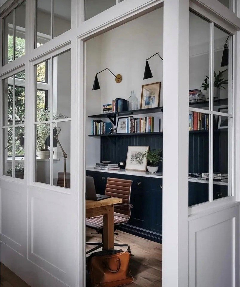

SUlrich Posted August 22, 2025 Share Posted August 22, 2025 I have a client looking for something similar, but I am not sure how exactly to go about this. I feel like I could use windows and add wainscot paneling to the wall. Just seems like there could be a better way. Any suggestions? Thank you. Link to comment Share on other sites More sharing options...
JKEdmo Posted August 22, 2025 Share Posted August 22, 2025 40 minutes ago, SUlrich said: I have a client looking for something similar, but I am not sure how exactly to go about this. I feel like I could use windows and add wainscot paneling to the wall. Just seems like there could be a better way. Any suggestions? Thank you. My first thought is do it all as mulled window units. For the lower "units" with the recessed panels, you could adjust the window frame widths and turn off the sashes. Change the glazing material to solid white. Mull everything together. Link to comment Share on other sites More sharing options...
