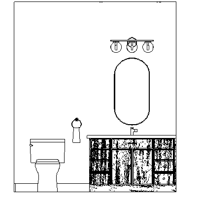

Kmanery Posted August 7 Share Posted August 7 Hi, I am trying to send my elevation to layout as plot lines, however the woodgrain texture is still visible in the layout. How do I get rid of the woodgrain JUST for the elevation in the layout? I've tried sending to layout without the Colour Fill selected and it doesnt work. Thank you! Link to comment Share on other sites More sharing options...
Alaskan_Son Posted August 7 Share Posted August 7 This should be moved to General Q&A, but all you need to do is toggle your "Patterns, 3D Views" layer in that specific layer set. Link to comment Share on other sites More sharing options...
