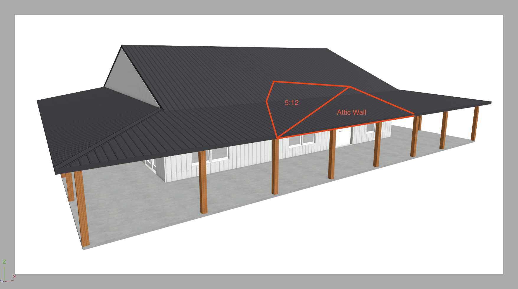

GrizzL Posted August 6, 2025 Share Posted August 6, 2025 I am trying to create a gable in the lower roof as pictured. I have tried using the gable/roofline tool to draw the width but it comes in at 2:12. When I select the roof planes and change the pitch it switches off auto roofs and leaves big holes in my existing roof. When I try manually drawing them I'm left with holes as well. I do understand that roofs are generated by the wall settings underneath so I toyed with those as well to no avail. I suspect I'm having trouble because I'm trying to connect to two different roof pitches. I have reviewed any relevant video resources in support and user sections but can't find anything exactly like what I'm attempting. Does anyone have any advice to achieve this? Quinlan-sandbox.plan.zip Link to comment Share on other sites More sharing options...
Solution Renerabbitt Posted August 6, 2025 Solution Share Posted August 6, 2025 54 minutes ago, GrizzL said: I am trying to create a gable in the lower roof as pictured. I have tried using the gable/roofline tool to draw the width but it comes in at 2:12. When I select the roof planes and change the pitch it switches off auto roofs and leaves big holes in my existing roof. When I try manually drawing them I'm left with holes as well. I do understand that roofs are generated by the wall settings underneath so I toyed with those as well to no avail. I suspect I'm having trouble because I'm trying to connect to two different roof pitches. I have reviewed any relevant video resources in support and user sections but can't find anything exactly like what I'm attempting. Does anyone have any advice to achieve this? Quinlan-sandbox.plan.zip 2.45 MB · 2 downloads use the gable line tool, put some other pitch in there and then change it again to 5. its a glitch Link to comment Share on other sites More sharing options...
