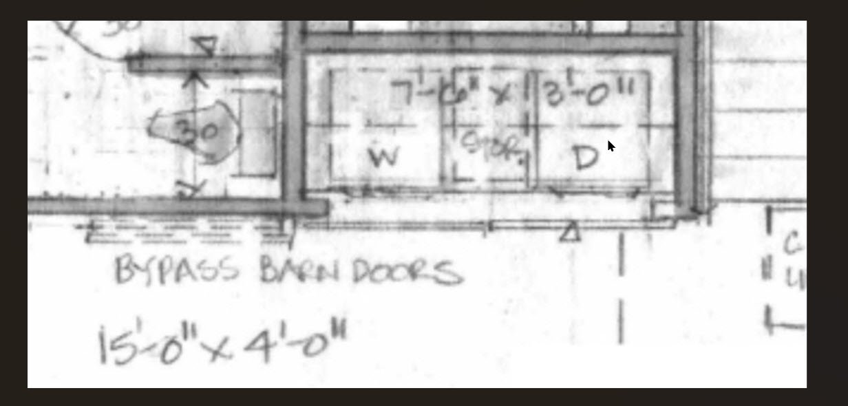

Wynsong Posted August 5 Share Posted August 5 Does anyone have a symbol for a bypass sliding barn door? The ones in Bonus Catalog Doors #1 Sliding Barn give components that I'm not having any luck putting together. For one thing I need two doors yet all the separate panels give you a door opening with it! Then I don't see the bypass track align with the front and rear facing rollers. Do you need two tracks? Or two tracks where the panels stack and one track over the doorway? Any wisdom on this would be appreciated. Thank you. Link to comment Share on other sites More sharing options...

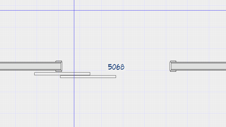

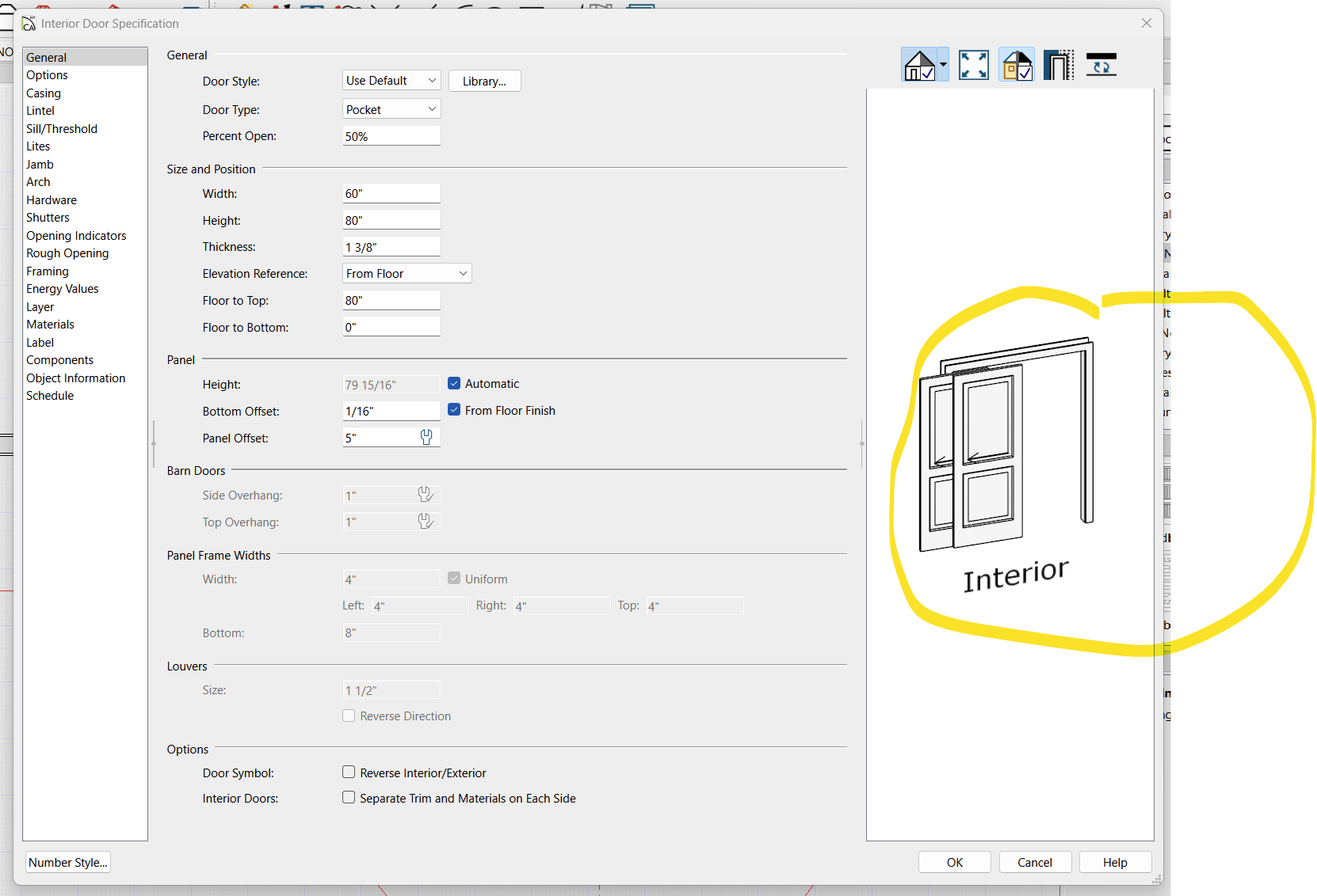

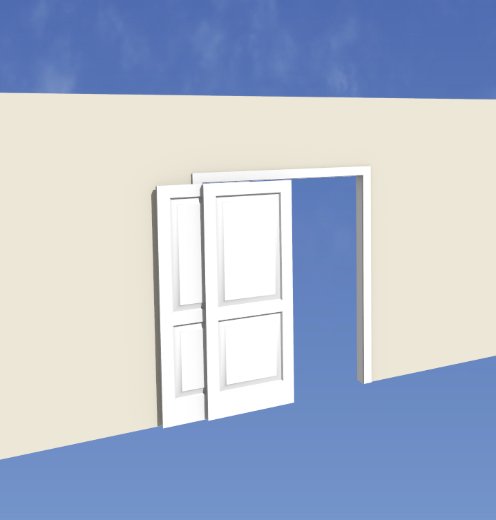

JKEdmo Posted August 6 Share Posted August 6 You might be able to get a pretty good representation by using an offset pocket door. I attached a PLAN file so you can take a look at the settings. TEST BYPASS BARN.plan 1 Link to comment Share on other sites More sharing options...
