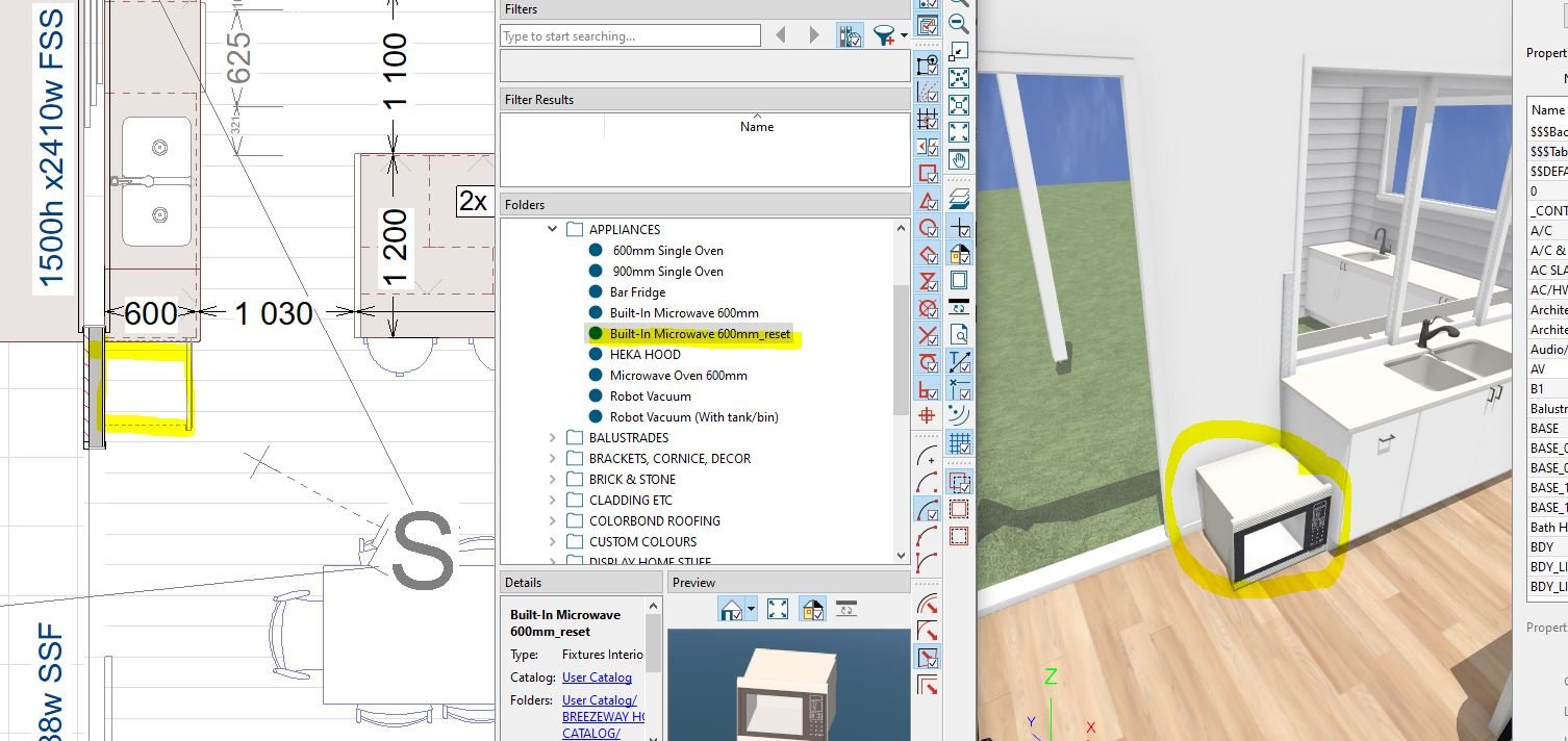

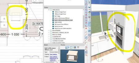

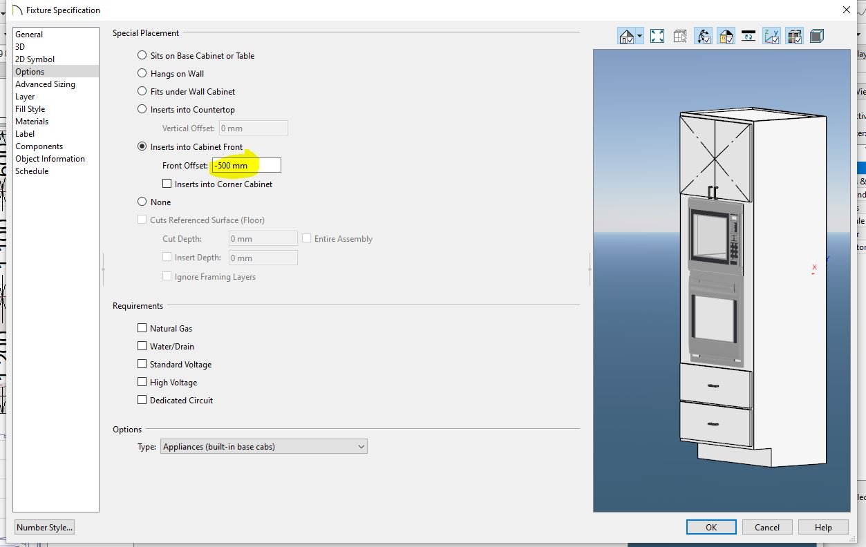

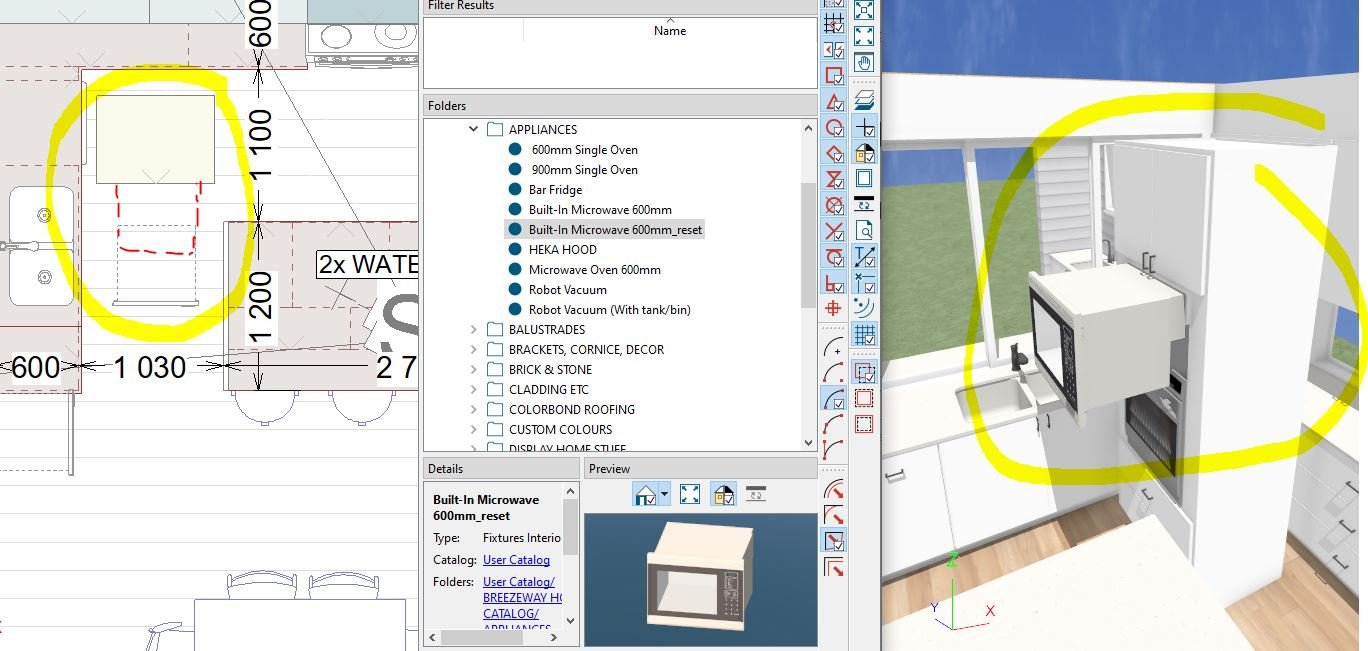

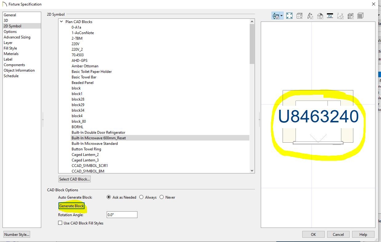

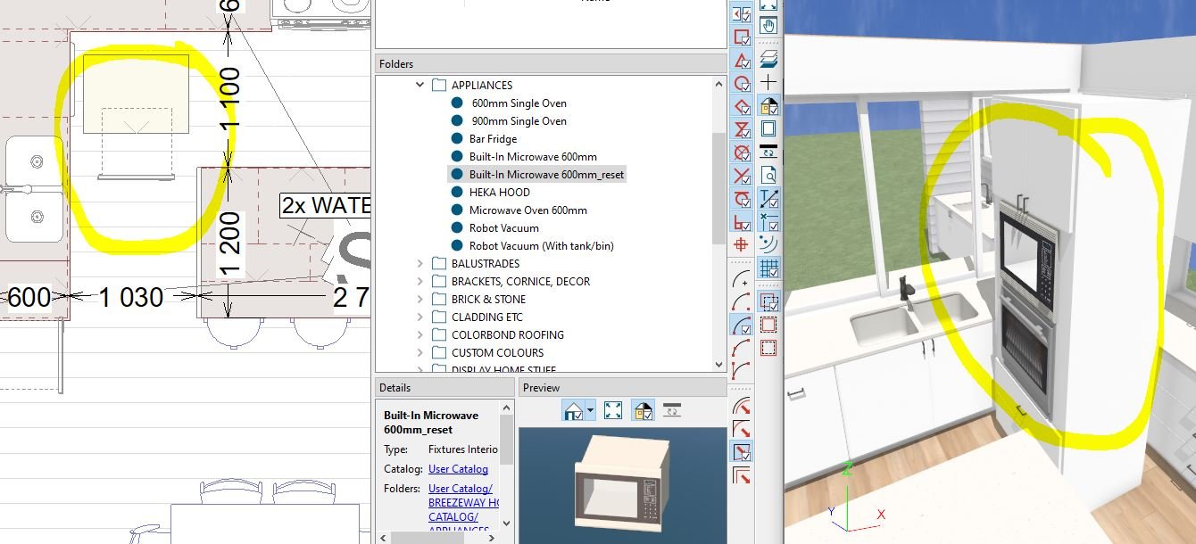

Breezeway01 Posted July 29, 2025 Share Posted July 29, 2025 Hi there Hoping someone can help. Since upgrading to X17, I seem to be having issues with the 2D symbols not matching up with the 3D when the appliance is inserted into cabinetry. For example – inserting a microwave into an oven tower. Everything matches up fine when the microwave is not inserted – all positional offsets are set at “0” However, as soon as I insert it into cabinetry, the 2D symbol does not match up with the 3D no matter what off-sets I have tried. Below I have only adjusted the front-offset so that the 3D looks correct. The 3D Origin offset and Advanced sizings are all still set at "0". But I have tried playing around with these too with no luck. The only thing that fixes this is re generating the 2D symbol but that is not the symbol I want. I just want it moved back to match the 3D! Hoping the screenshots explain this better. We have been using these exact appliances/oven tower in X16 with no issues. Thanks Link to comment Share on other sites More sharing options...

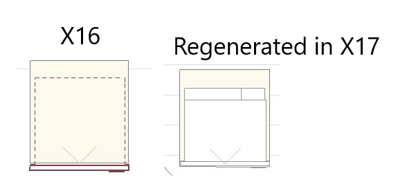

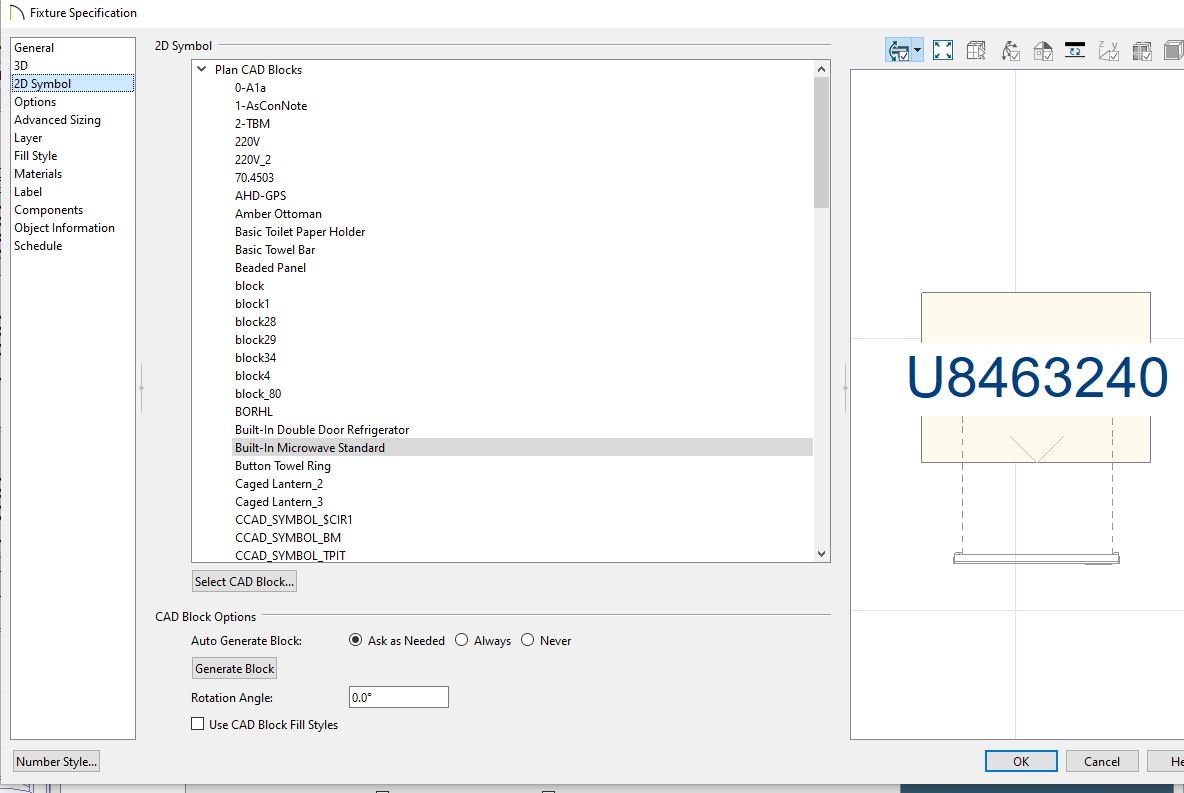

Renerabbitt Posted July 30, 2025 Share Posted July 30, 2025 2 hours ago, Breezeway01 said: Breezeway_Kitchen_issues_1.0.plan 10.25 MB · 1 download Thank you. Will the attached file be sufficient? Is there a reason you do not want to auto generate. Your old 2d is not the correct depth. If you insist, just copy the old 2d cad, regenerate the cad, and paste your old 2d cad in and delete the old, then save. Also D/W are not supposed to insert into cabinet fronts anymore, they are standalone. So you would change the symbol option to undercounter appliance and resize the height for an auto countertop to generate without the need of a cabinet Link to comment Share on other sites More sharing options...
Breezeway01 Posted July 30, 2025 Author Share Posted July 30, 2025 1 hour ago, Renerabbitt said: Is there a reason you do not want to auto generate. Your old 2d is not the correct depth. If you insist, just copy the old 2d cad, regenerate the cad, and paste your old 2d cad in and delete the old, then save. Also D/W are not supposed to insert into cabinet fronts anymore, they are standalone. So you would change the symbol option to undercounter appliance and resize the height for an auto countertop to generate without the need of a cabinet The reason I do not want to auto generate the microwave is because the new symbol is overbearing and does not match our exisitng plans. After quite a bit of trial and error, I managed to edit the CAD symbol back to the old one after auto generating and it worked! Thank you! Just frustating that I will have to do this for all items I want to insert into cabinetry. Yes I understand the whole dishwasher update and are happy to just pop it under the counter, however we don't want to do this with the microwave as it is in-built into our cabinetry. Link to comment Share on other sites More sharing options...
