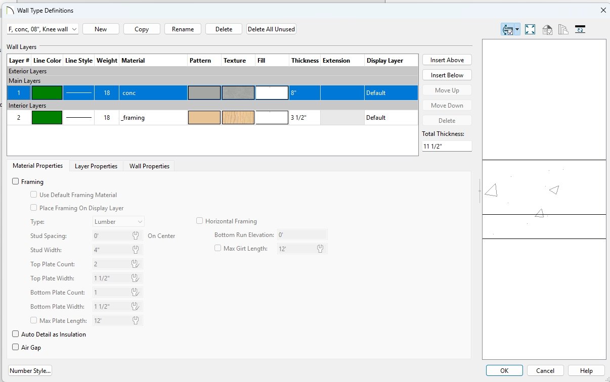

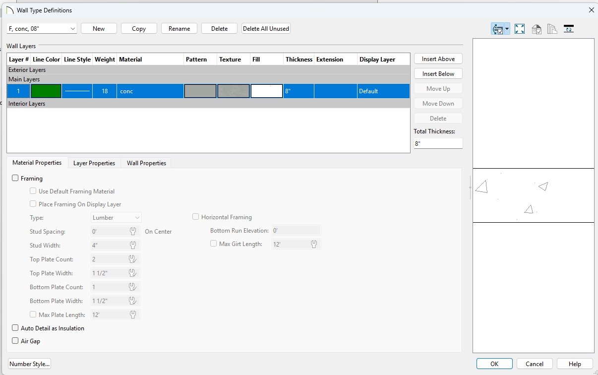

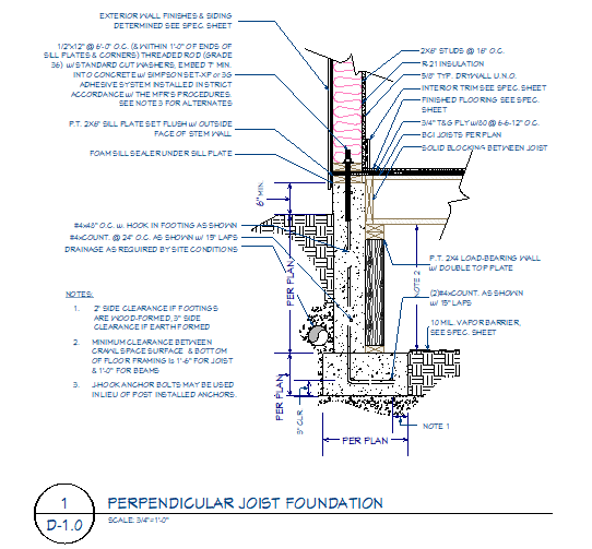

ABG_Car Posted July 21, 2025 Share Posted July 21, 2025 Hi Everyone, I am in need of a little bit of help. So overview I have trying to create a custom foundation wall type that I use regularly with in my house designs. I've created a CAD detail for this foundation type but now I'm trying to implement it into my models as I draw so when I go to do sections and place my floor joist it works and functions the same way as my detail does. I have attached image of the detail I created along with the foundation wall type I'm trying to create. Is there a way to select the 2x4 knee wall that the joist is suppose to sit on and have it be lower to the ground/footing so the T.O. my joist sits flush with the sill plate that is on the concrete foundation? At this point in time i can change the height and it changes both layers of the wall type to be the same height but Id love to separate it and give the 2x4 layer a restriction/limiter that tells it to be 11 3/4" lower than the T.O. of the foundation wall. I know i could put in my foundation and then go back through my plan and draw the 2x4 wall lower than the T.O. of the foundation but that takes extra time and if there is a way to create it so it works that would be amazing. Thank you for your help and knowledge in advance! Respectfully, - ABG_Car Link to comment Share on other sites More sharing options...

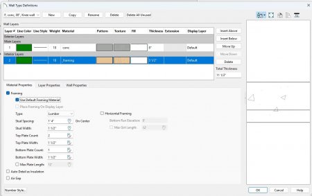

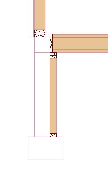

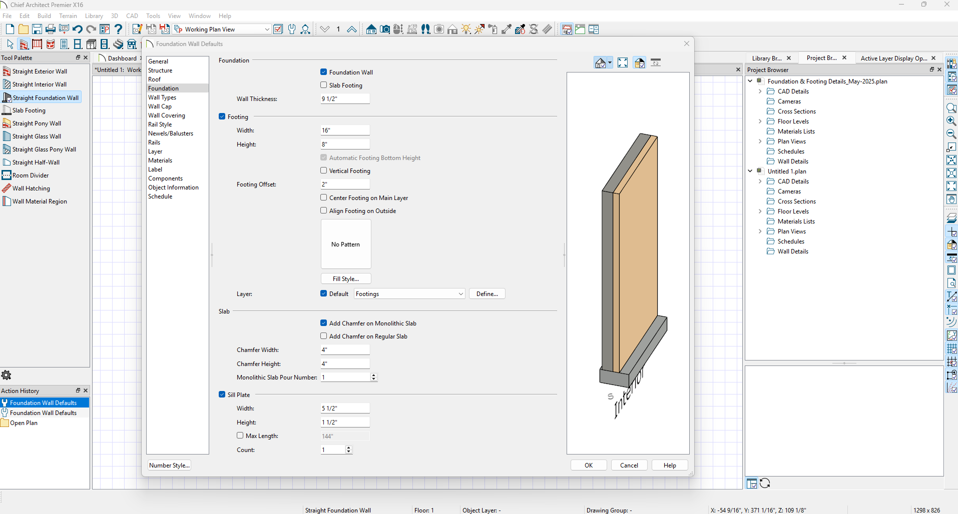

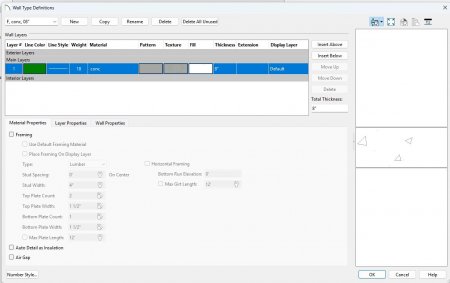

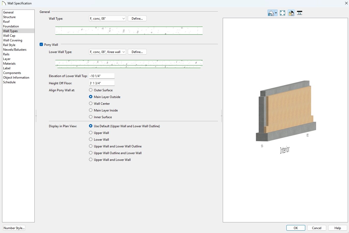

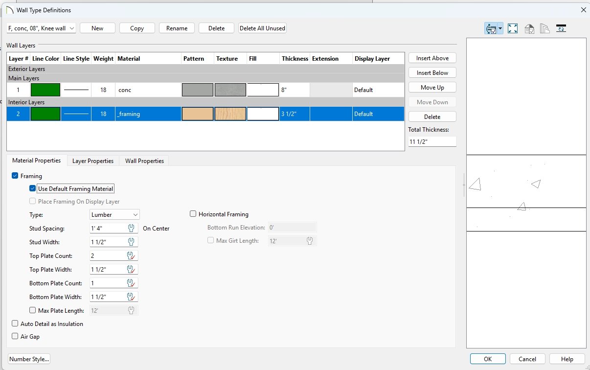

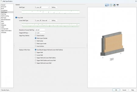

Solution rlackore Posted July 22, 2025 Solution Share Posted July 22, 2025 You can accomplish this with pony walls. Define two wall types: 1) the lower wall type will include the framed knee wall; be sure you set the knee wall layer to framing and set up the particulars in the dbx 2) the upper wall type is just your basic concrete wall, no knee wall framing Next, select your foundation walls and turn them into pony walls; set the Elevation of Lower Wall Top to the thickness of your floor framing (I-joist + subfloor), this will build the lower wall type with the knee wall to just beneath the floor framing: Build Framing and cut a section to see the result. Of course you have to set up your stem wall height, define the foundation walls so the floor hangs off the inside with a ledger, etc.: This gets you most of the way there. Auto-detailing isn't 100%, it details the knee wall as concrete, but you can easily fix that manually. 1 Link to comment Share on other sites More sharing options...
