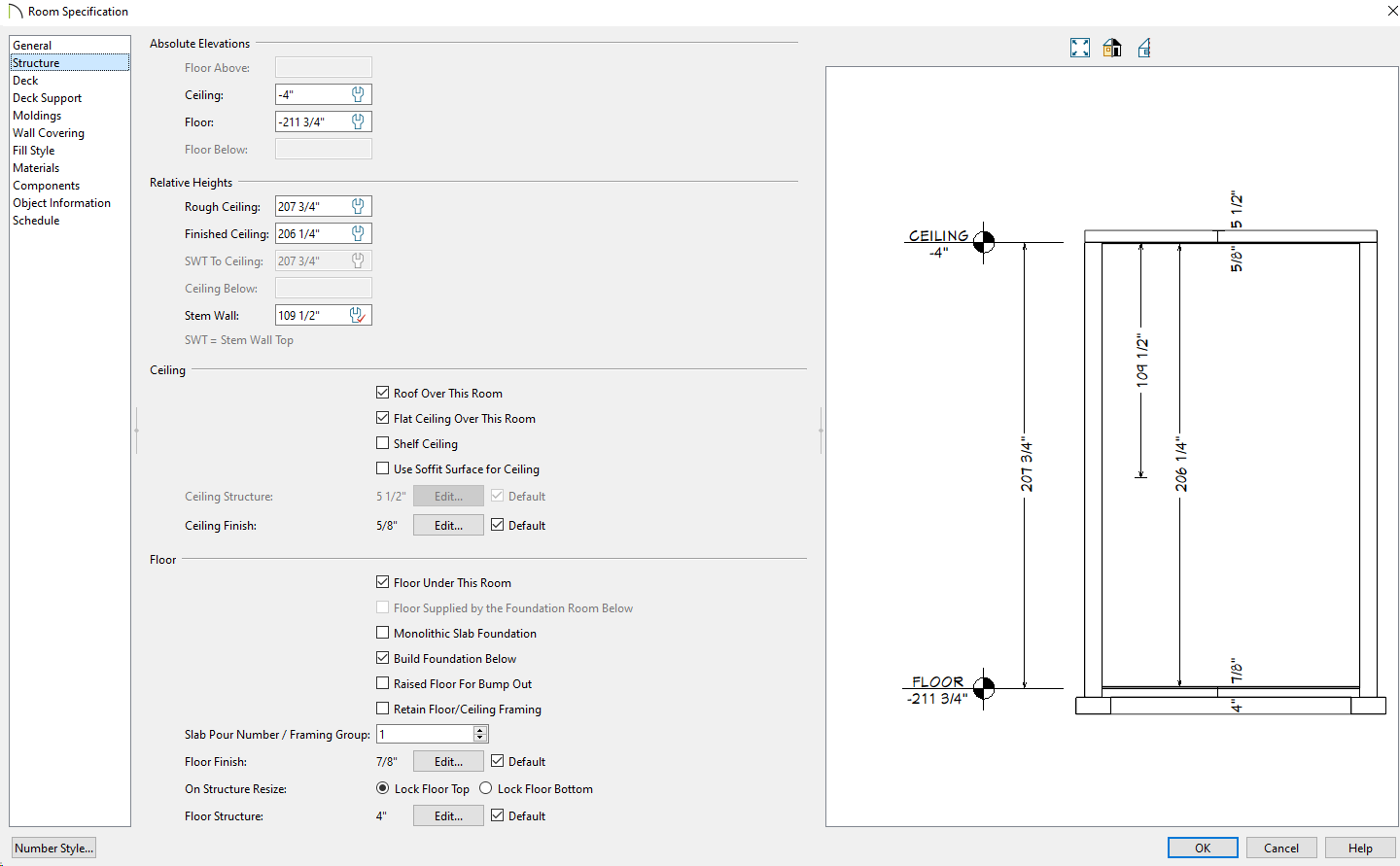

Troywj Posted May 2, 2025 Share Posted May 2, 2025 This weird foundation outline keeps coming back and I don't know why. Any help would be greatly appreciated. When I click on it, it says it's a room. In the specifications it shows this And this is structure. After I change all the values to what it's supposed to be it looks right but then as soon as I do anything in the file it reverts back to these same settings. Any ideas? Chief Architect Premier X16 Link to comment Share on other sites More sharing options...
javatom Posted May 2, 2025 Share Posted May 2, 2025 Your rough ceiling default is 207". That is causing everything to drop down. Change it so the ceiling is correct. It looks like you are going for a 9' ceiling. Link to comment Share on other sites More sharing options...
Troywj Posted May 5, 2025 Author Share Posted May 5, 2025 Thank you for the reply! Yes, it does show that in the screenshot. After I change all those values to what they are supposed to be everything looks correct and good. However, if I do anything in the file it all reverts back to these same settings with that same weird thing. I can't find what is causing this to happen. Link to comment Share on other sites More sharing options...
javatom Posted May 5, 2025 Share Posted May 5, 2025 Your floor defaults might be set wrong. Check the ceiling settings for level 0 defaults. It could be trying to reset it to what is shown there. Link to comment Share on other sites More sharing options...
Troywj Posted May 12, 2025 Author Share Posted May 12, 2025 Defaults all seem to be set correctly. I've attached the plan file if someone can figure this out. Or I can try contacting CA support. I guess the file is too big to attach so here's a link to it. Link to comment Share on other sites More sharing options...
LCDesigns Posted May 12, 2025 Share Posted May 12, 2025 Look at your stem wall height vs your ceiling height. Link to comment Share on other sites More sharing options...
Troywj Posted May 12, 2025 Author Share Posted May 12, 2025 Never mind. I had to change all the furred walls in the basement to actual furred walls then it fixe it. Thanks for the help! Link to comment Share on other sites More sharing options...
