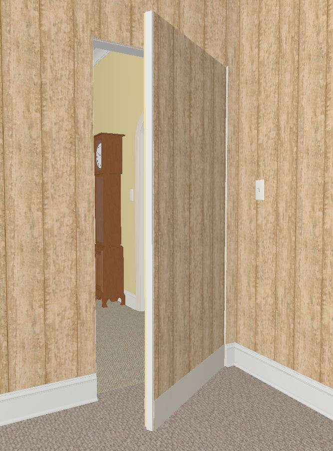

This is clever! What technique did you use to create the door?
Change the door to slab with hidden hinges. No knob/door locks, nothing. Suppressed the interior casing, increased the door thickness to 4" (which matches the thickness of the interior wall). Created a polyline solid (1/2" thick) and matched it to the size of the entire door, using the same wall pattern for the material, and placed it over the door on both sides, initially covering the door itself. As for the base trim. Created a soffit, sized it down to 1/8" thick and added the same molding as the rooms. After several adjustments, grouped all shapes into one element, rotated to desired angle, opened the door and set its open angle to match, more adjustments and there you have it.

Very Nice! I would be handy if we could take it a step farther and attach a molding, like the base you have, directly to a slab door so that you could save the whole thing to your library as a custom door style.
Thanks for sharing!
