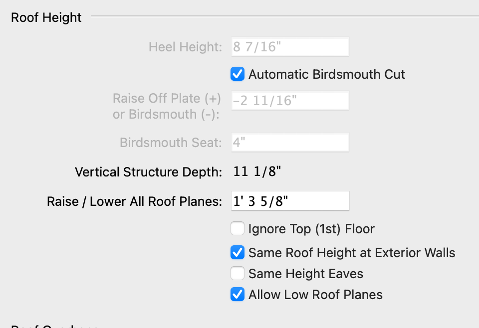

CA_Russell Posted March 18 Share Posted March 18 All, I'm wondering what should be the best method for using the AutoRoof function to ensure that the roof is sitting at the desired height. It would seem out of the box, there are some weird functions that are happening where the roof is landing higher than anticipated. For clarification, I'm not a roofer, but I do understand that when viewed from a cross-section that the birdsmouth should land over the top plate. And why is the value "Raise / Lower All Roof Planes" arriving at '1' 3 5/8' for an AutoRoof? Where is this value being pulled from?? - Ryan Link to comment Share on other sites More sharing options...

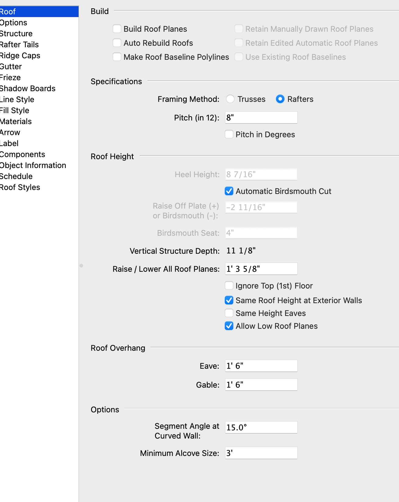

CA_Russell Posted March 18 Author Share Posted March 18 For additional data, this is a 8:12 roof on a 10' plate. Link to comment Share on other sites More sharing options...

JiAngelo Posted March 18 Share Posted March 18 (edited) Your rafters are 2x10s. On an 8/12 pitch, the vertical plumb cut depth is approximately 11 1/8" Forgot to add that you didn't show the plan. You may have some other roof intersections that are raising the roof planes so that the facia plane out all around the building. Edited March 18 by JiAngelo Forgot 2nd question Link to comment Share on other sites More sharing options...
crdsplans Posted March 18 Share Posted March 18 I design everything i do with wood trusses with a 12" cantilever overhang and a 2x6 subfascia so my vertical i basically 6" + pitch Link to comment Share on other sites More sharing options...
