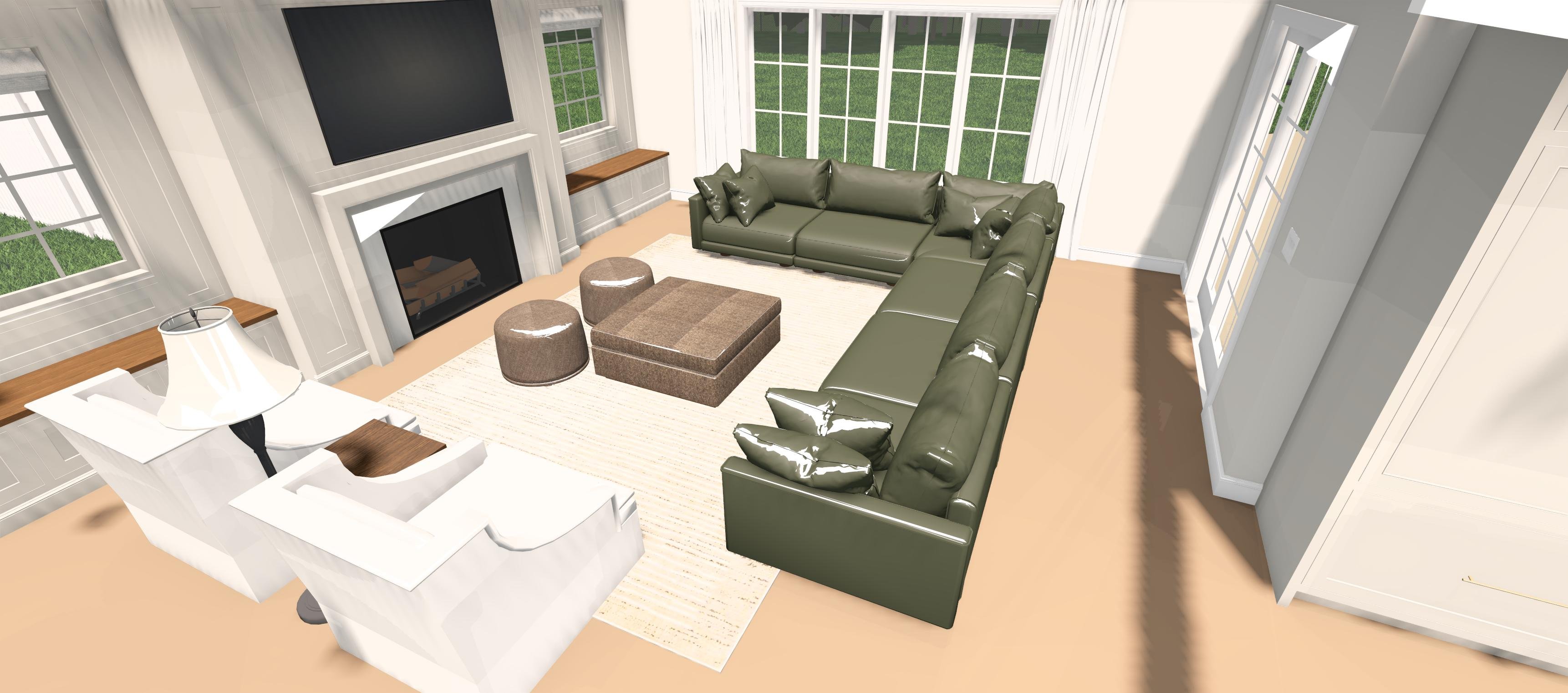

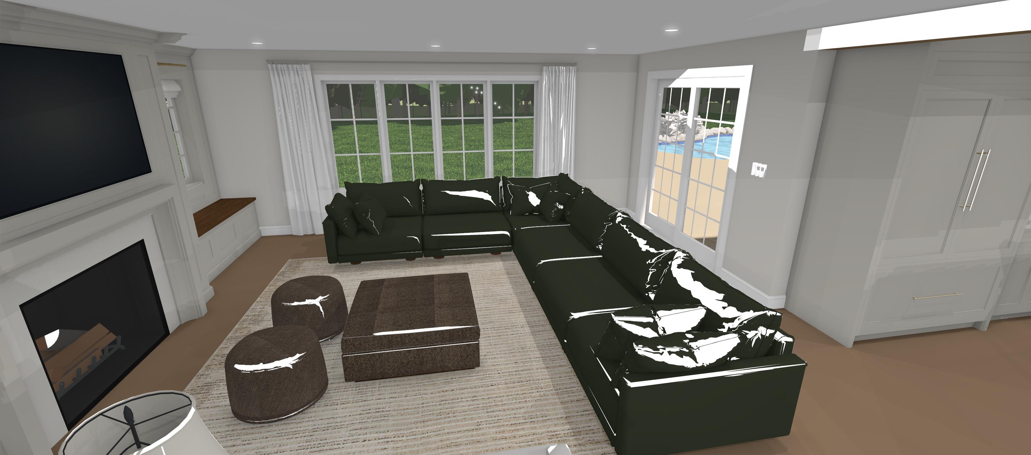

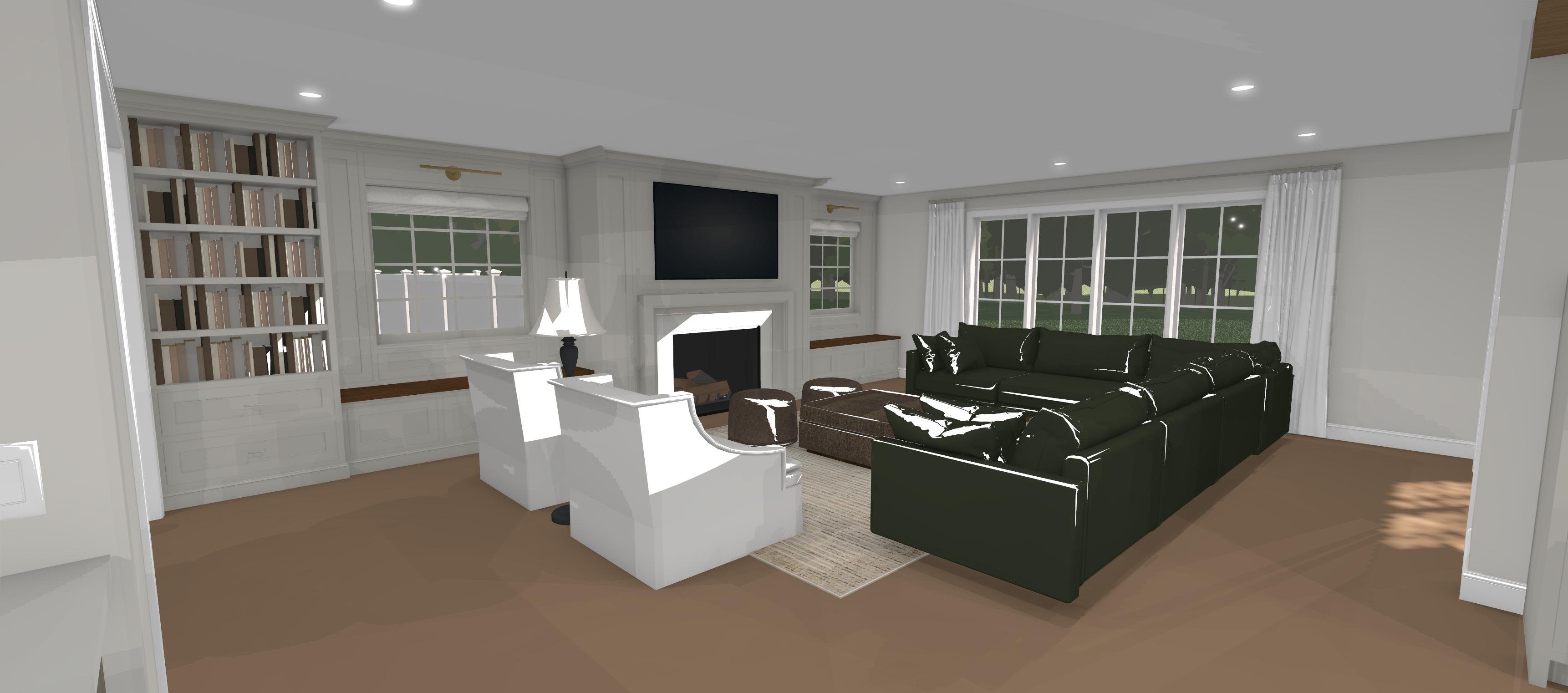

On one of my computers, whenever I switch to the camera view (both full camera and perspective views), parts of the model show a white visual glitch. It looks almost like the lighting is overexposed.
The strange part is that I can’t reproduce the issue on any of my other computers using the same project. Because of that, I’m wondering if it might be related to the graphics card or drivers on this computer. Has anyone run into something like this before or know what might cause it?

Hello @RefinedRen,
Based off of you screenshots this looks like an issue that was fixed with one of our program updates. I would guess that you have the most up to date version on your other systems, but not this system.
You can check if an update is available by going to Help> Download Program Updates within the program.
If you're already on the latest version I would recommended contacting our Technical Support team through the Technical Support Center.
