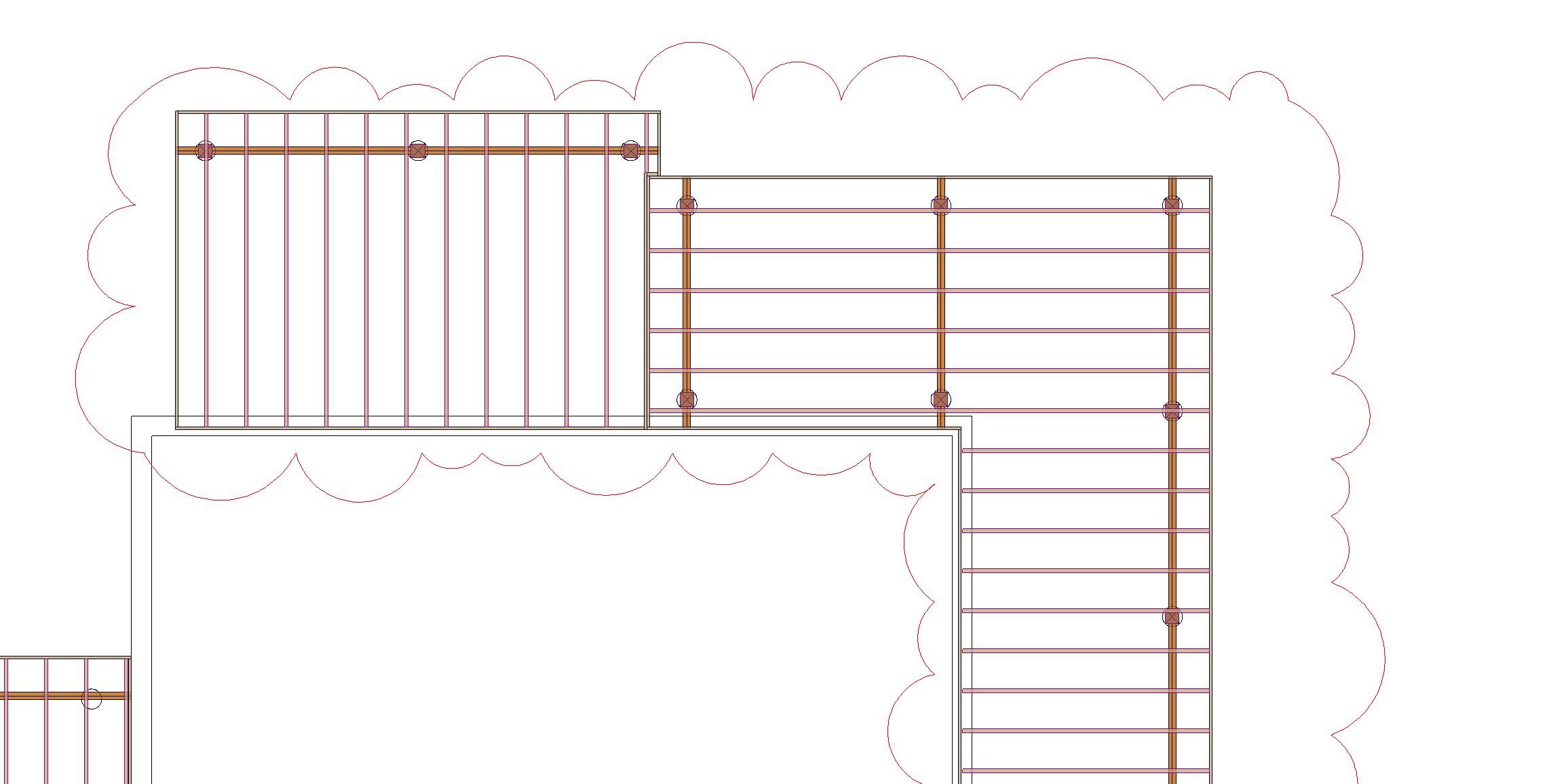

KacyRSC Posted 4 hours ago Share Posted 4 hours ago (edited) Hi all. I'm not sure why this is happening since I installed x17, but alas, I've been running into this issue lately where the deck framing extends into/through the nearest exterior wall instead of butting into it. It's inconsistent too. Sometimes the auto framing for a deck works great, other times not so much. Is this a known bug? Do any power users have any suggestions? Plan is uploaded to google drive. Link is below. Let me know if you have any issues accessing. https://drive.google.com/file/d/1rb3Gv5PiMthD_k3CGdOX2ub9iyhZCAJK/view?usp=sharing Thanks in advance! Edited 3 hours ago by KacyRSC Added Image Link to comment Share on other sites More sharing options...

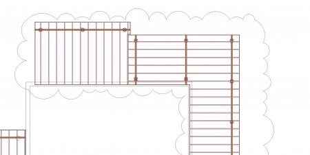

KacyRSC Posted 3 hours ago Author Share Posted 3 hours ago Solved! Under the "structure" tab of the deck room dbx I had to change the "slab pour number/framing group" to match the first floor. Fixed it instantly. Maybe this will help someone in the future. 1 Link to comment Share on other sites More sharing options...
