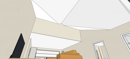

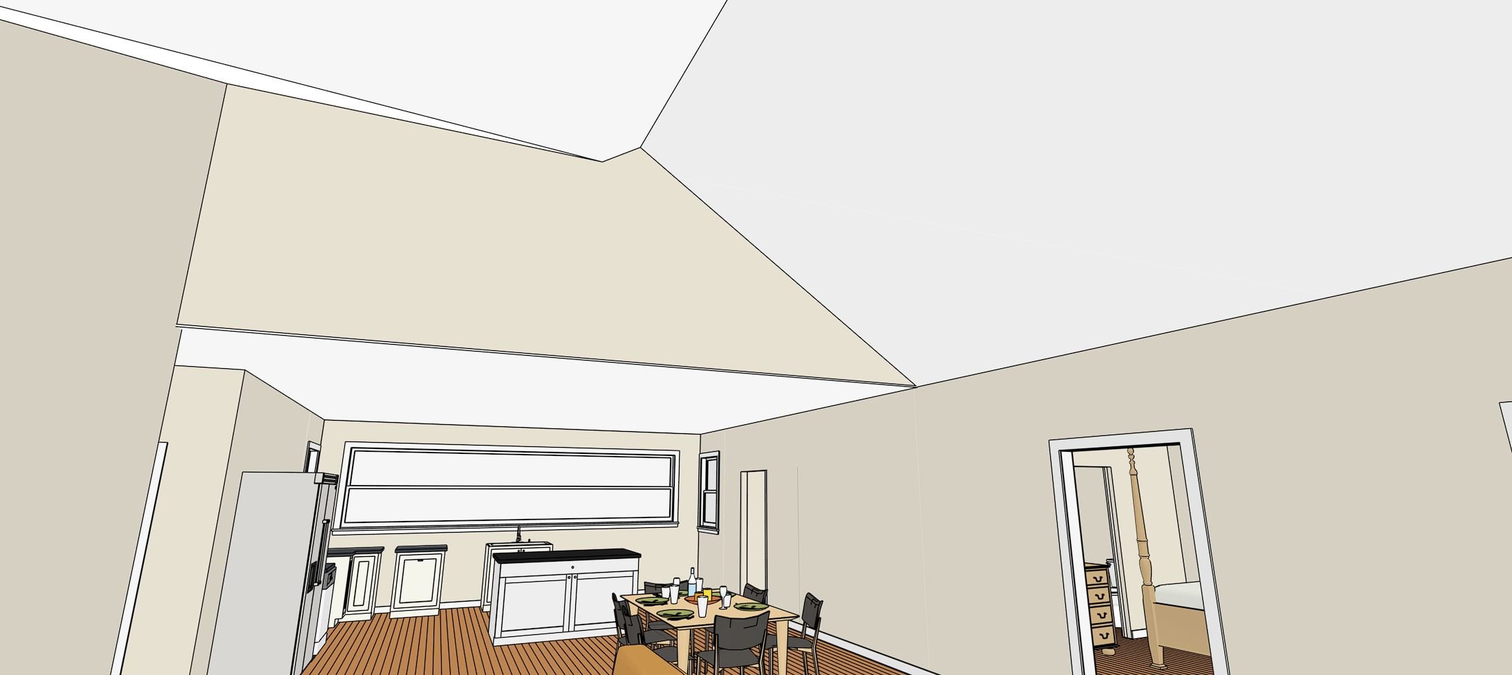

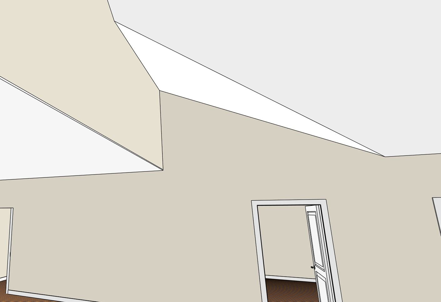

megclay Posted January 28 Share Posted January 28 How do I remove the vaulted ceiling extra areas (the two smaller triangles) I have the auto rebuild settings on I looked for videos on this but with no luck Link to comment Share on other sites More sharing options...

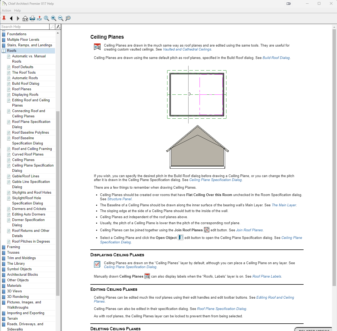

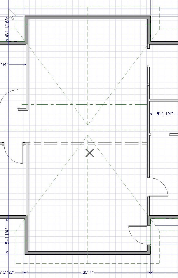

tundra_dweller Posted January 28 Share Posted January 28 Create custom ceiling planes through the entire vaulted area that match the slope and height of your roof plane's ceiling finish layers. Your custom ceiling planes should then cover those inverted vault areas and be co-planar with your main vault ceiling. 1 Link to comment Share on other sites More sharing options...
megclay Posted January 28 Author Share Posted January 28 30 minutes ago, tundra_dweller said: Create custom ceiling planes through the entire vaulted area that match the slope and height of your roof plane's ceiling finish layers. Your custom ceiling planes should then cover those inverted vault areas and be co-planar with your main vault ceiling. Thanks for the reply Do you have easy instructions looked up custom ceiling plane under help with no luck I just started to use this software so I am really a newbe Link to comment Share on other sites More sharing options...

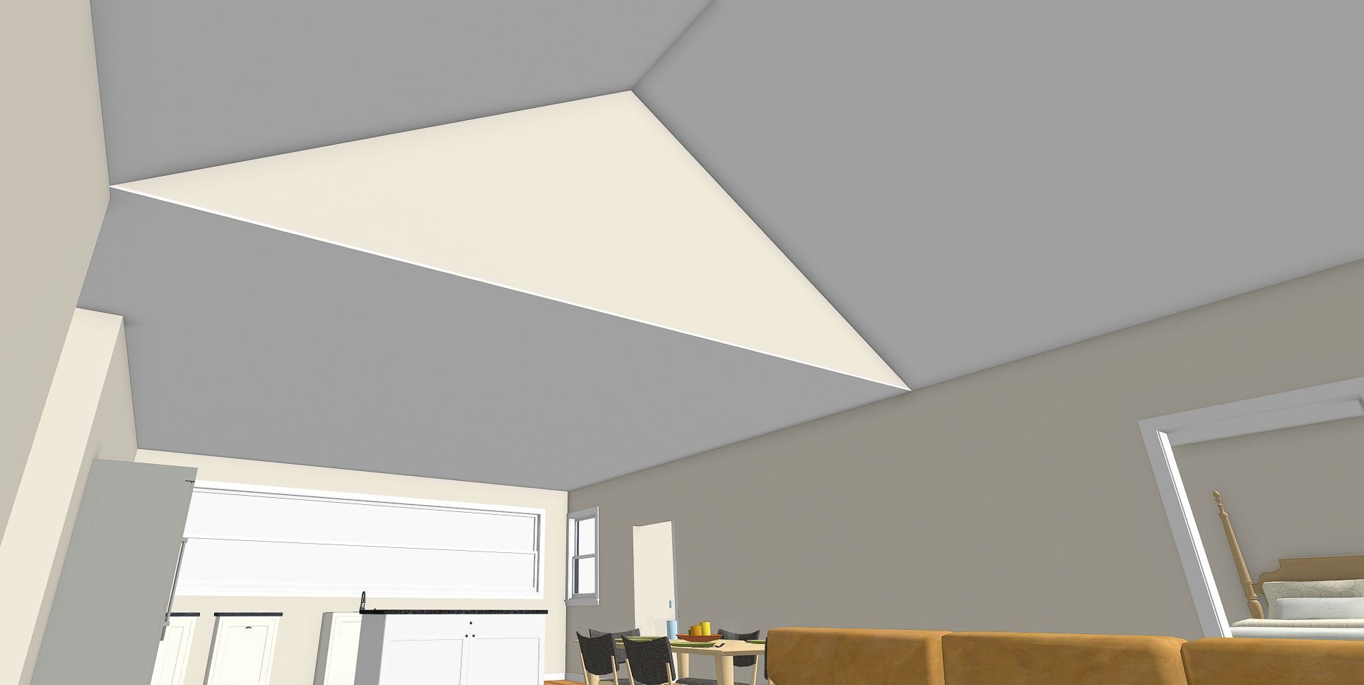

megclay Posted January 28 Author Share Posted January 28 (edited) 34 minutes ago, megclay said: Thanks for the reply Do you have easy instructions looked up custom ceiling plane under help with no luck I just started to use this software so I am really a newbe added a ceiling plane in the plan view and it fixed one side but the other side is still he same (found a video watching now) Edited January 28 by megclay updating Link to comment Share on other sites More sharing options...
Solution tundra_dweller Posted January 28 Solution Share Posted January 28 Hit F1 to open up the help files in Chief and search for ceiling planes, or do a youtube search for some videos. Otherwise I think you're going to have to post your plan to get better help on here. Link to comment Share on other sites More sharing options...
megclay Posted January 28 Author Share Posted January 28 43 minutes ago, megclay said: added a ceiling plane in the plan view and it fixed one side but the other side is still he same (found a video watching now) yes that worked with the video thank you here is another one https://www.homedesignersoftware.com/videos/watch/2245/custom-ceiling-planes.html 1 Link to comment Share on other sites More sharing options...
