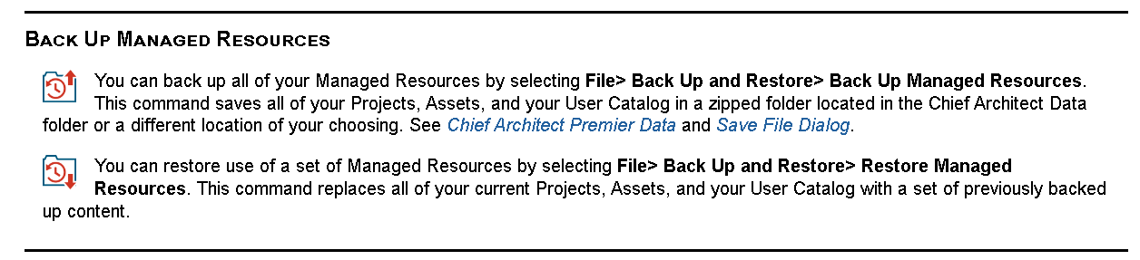

jorgearaya Posted yesterday at 05:33 PM Share Posted yesterday at 05:33 PM If you are like me that I'm always keeping an eye on disk space "This PC" on Windows and noticing how the space goes up and down depending on usage as well as how it had suddenly gone up after using the Project Management option. It has to do with how this feature saves backups of ALL YOUR PROJECTS, ASSETS, USER CATALOGS, ETC. each time it does a backup. The backups are there as a failsafe and can easily be moved to an external drive, or a cloud service if you deemed necessary to move them out to keep your disk space from getting filled up. You can find the backup folder location by going to Preferences>General>Folders>All program paths>Show. Hope this helps! 1 Link to comment Share on other sites More sharing options...
