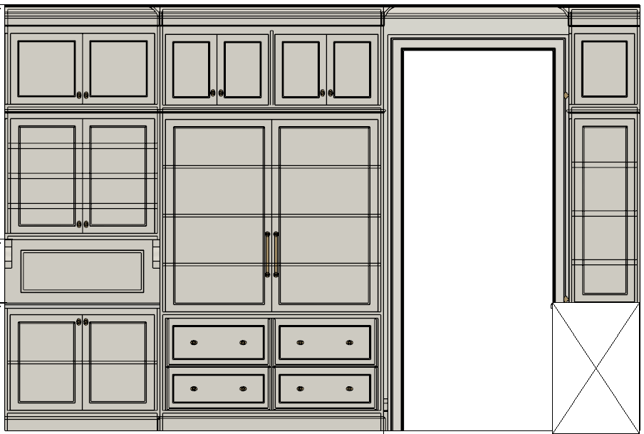

SteveTiek Posted 8 hours ago Share Posted 8 hours ago Some of my elevations are showing up normal but other elevations in the same file are showing extra lines like this image. How do I fix this? Link to comment Share on other sites More sharing options...
ChiefTylerL Posted 8 hours ago Share Posted 8 hours ago Hello @SteveTiek, I have seen this behavior before when the plan is very far from the plan's origin point. (x:0, y:0). This can typically be resolved by using the Edit Area (All Floors) tool to move your design back to 0,0. Here is a resource that will walk you through those steps: https://www.chiefarchitect.com/support/article/KB-03124/troubleshooting-origin-error-messages.html If this doesn't seem to resolve the issue, or if you would like assistance, please contact us via the Technical Support Center: https://www.chiefarchitect.com/support/article/KB-00717/using-the-technical-support-center.html I hope this helps! Link to comment Share on other sites More sharing options...
SteveTiek Posted 7 hours ago Author Share Posted 7 hours ago 14 minutes ago, ChiefTylerL said: u would like assistance, please contact us via the Technical Support Ce Ok great. When I started the steps to the link you sent me I found that there was this line object really far away from my floor plan. The only problem is that I can't select it to delete it. I've made sure that all locked layers were turned off and even turned off all CAD layers to see if it was that but it is still there. How can I fix this so that when I "Select All" it just selects my floor plan. Link to comment Share on other sites More sharing options...
ChiefTylerL Posted 6 hours ago Share Posted 6 hours ago Aha, far away objects will cause similar behavior! This article will walk you through identifying and deleting far away objects: https://www.chiefarchitect.com/support/article/KB-00021/troubleshooting-small-or-blank-camera-overviews.html Sometimes these can be very very far away and can be tricky to delete (like not being able to be selected normally). If you're unable to delete this object following the resource above please submit a ticket through our Technical Support Center. Using the Technical Support Center: Technical Support Center: https://www.chiefarchitect.com/support/article/KB-00717/using-the-technical-support-center.html I hope this helps! Link to comment Share on other sites More sharing options...
