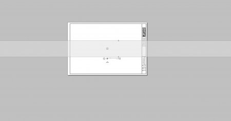

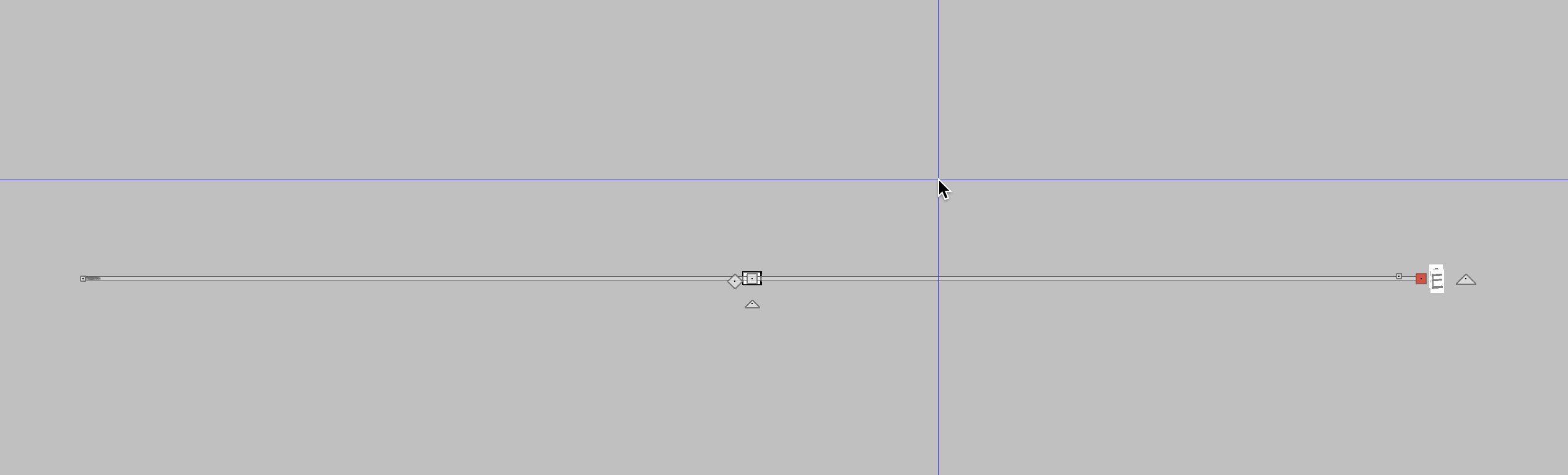

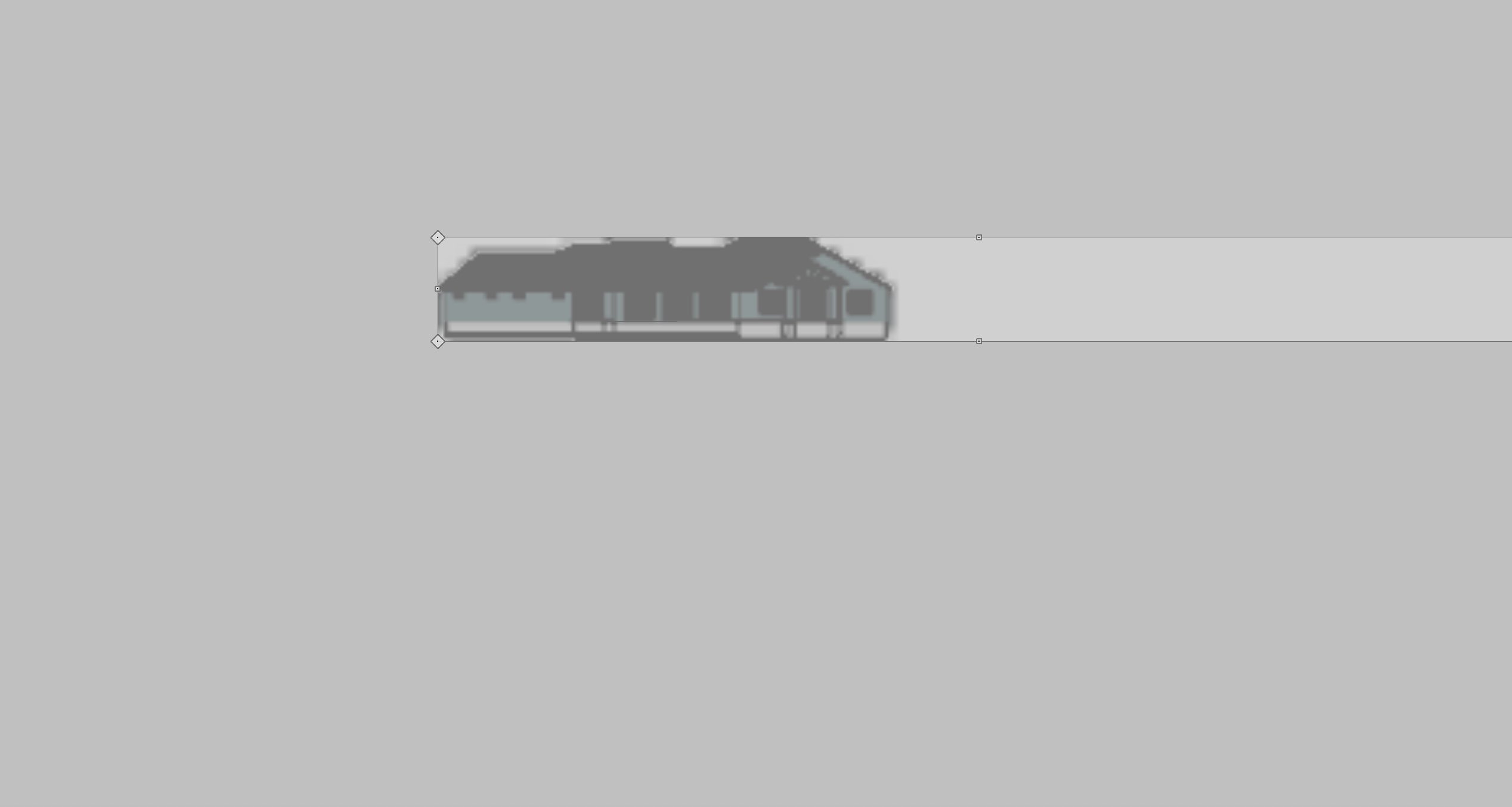

Chiefuser3gc Posted January 16 Share Posted January 16 Hello! looking of some help with finding a random object or text box.......when I try to share my elevation it the layout box in plan view is very very wide. the label lands center but the house elevation is pushed way to the left if you scroll way to the right in plan view I can see a blurry object I'm not positive what it is. Can someone help me locate what this is? Link to comment Share on other sites More sharing options...

ChiefTylerL Posted January 16 Share Posted January 16 Hello @Chiefuser3gc, You can find far away objects in your plan view, and once deleted your elevation should appear normal again. This resource will walk through locating and deleting far away objects: https://www.chiefarchitect.com/support/article/KB-00021/troubleshooting-small-or-blank-camera-overviews.html I hope this helps! 1 Link to comment Share on other sites More sharing options...
Chiefuser3gc Posted January 16 Author Share Posted January 16 13 minutes ago, ChiefTylerL said: Hello @Chiefuser3gc, You can find far away objects in your plan view, and once deleted your elevation should appear normal again. This resource will walk through locating and deleting far away objects: https://www.chiefarchitect.com/support/article/KB-00021/troubleshooting-small-or-blank-camera-overviews.html I hope this helps! Thank you!! I had a random attic wall what felt like a mile away!! Very appreciated 1 Link to comment Share on other sites More sharing options...
