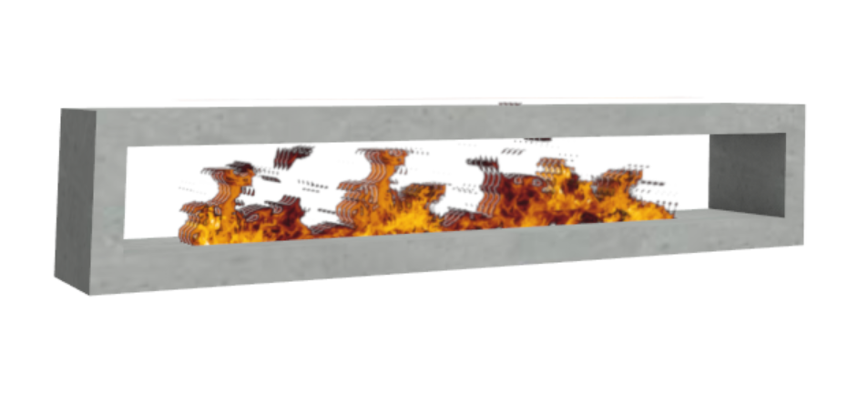

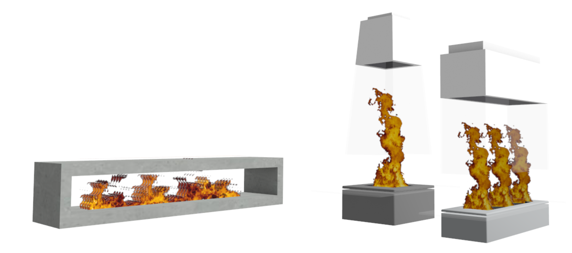

JiAngelo Posted September 30, 2025 Share Posted September 30, 2025 Using a polyline solid, make the box you want to subtract an inch or two bigger than the object it is being subtracted from. For instance, if the opening you need is 12 high x 80" long, in a box that is 24" deep, then make the box you will be subtracting 28" deep (extending 2" past the polygon to remain in the front & rear directions) This is the result after I added (4) "Fire 6" objects from Modern No.1 Fireplaces Library (evenly spaced to give the 2D fire depth.). Additionally, that same library has a couple of glass fireplaces that appear similar to what you've described. I added 3D "Flame 6" to both fireplaces. I really can't tell what you are trying to achieve from your description and PDF. From the Aquafire website, These images are 3 sided, not four sided This image is 4 sided, but lacks any glass detailing around the fireplace This image is see-thru, which is similar to what I drew using poly object subtraction . 1 Link to comment Share on other sites More sharing options...
