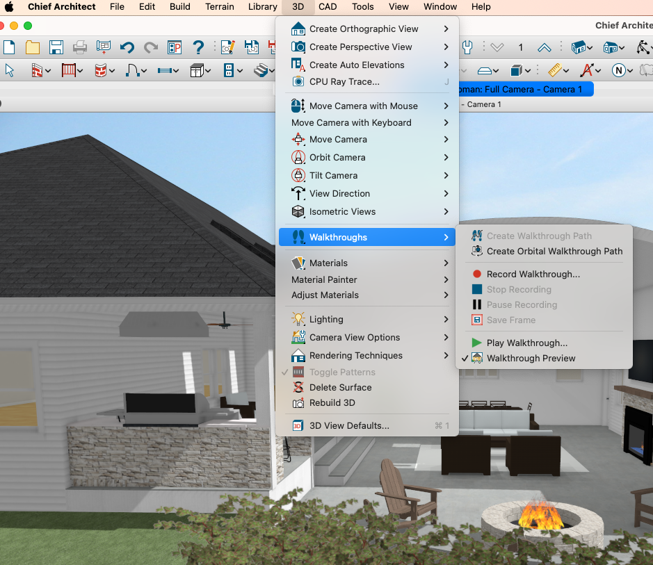

AffinityHD Posted September 18, 2025 Share Posted September 18, 2025 Hello, i've watched countless youtube videos and tutorials, but I am missing a crucial button that everyone else has "create stationary walkthrough". I have my north pointer, a few sun angles, and when im in my 3D view, stationary walkthrough isn't listed as an option? I am trying to show a client a sun study and where the shadows will lie throughout the day. Link to comment Share on other sites More sharing options...
Solution StevenK Posted September 18, 2025 Solution Share Posted September 18, 2025 Are you using X17? The feature is new to X17. Link to comment Share on other sites More sharing options...
AffinityHD Posted September 18, 2025 Author Share Posted September 18, 2025 4 minutes ago, StevenK said: Are you using X17? The feature is new to X17. Ah, just checked for the update! I have it now. Thank you! 1 Link to comment Share on other sites More sharing options...
