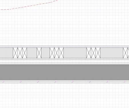

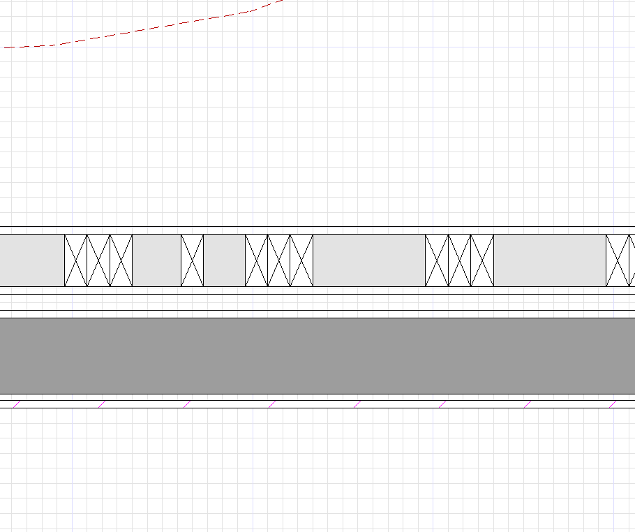

HillsBuild Posted September 2, 2025 Share Posted September 2, 2025 Hi All! New here and new to chief architect. I'm still learning and hoping to get some help. I am not an architect. I use this software for rough designs on remodels. I'm working on a basement buildout that we will not be finishing the ceiling on. My wall framing is being constructed like the picture with triple studs under all of the floor joists. Is there a way to easily fix this other than adjusting each wall one stud at a time? Link to comment Share on other sites More sharing options...
PitMan71 Posted September 2, 2025 Share Posted September 2, 2025 That's strange... probably some setting. We could be more helpful if you would post your plan. You will need to exit the plan and compress it to upload. Link to comment Share on other sites More sharing options...
HillsBuild Posted September 2, 2025 Author Share Posted September 2, 2025 Hopefully this does the trick. Sidoti Plans.zip 1 Link to comment Share on other sites More sharing options...
PitMan71 Posted September 2, 2025 Share Posted September 2, 2025 Alright.... Took a minute BUT all of your floor joists are drawn as a BEAM instead of a joist. The software is assuming that you want a stud pack there to transfer load. If you change your beams to joists and reframe the wall it should frame normally. 1 Link to comment Share on other sites More sharing options...
