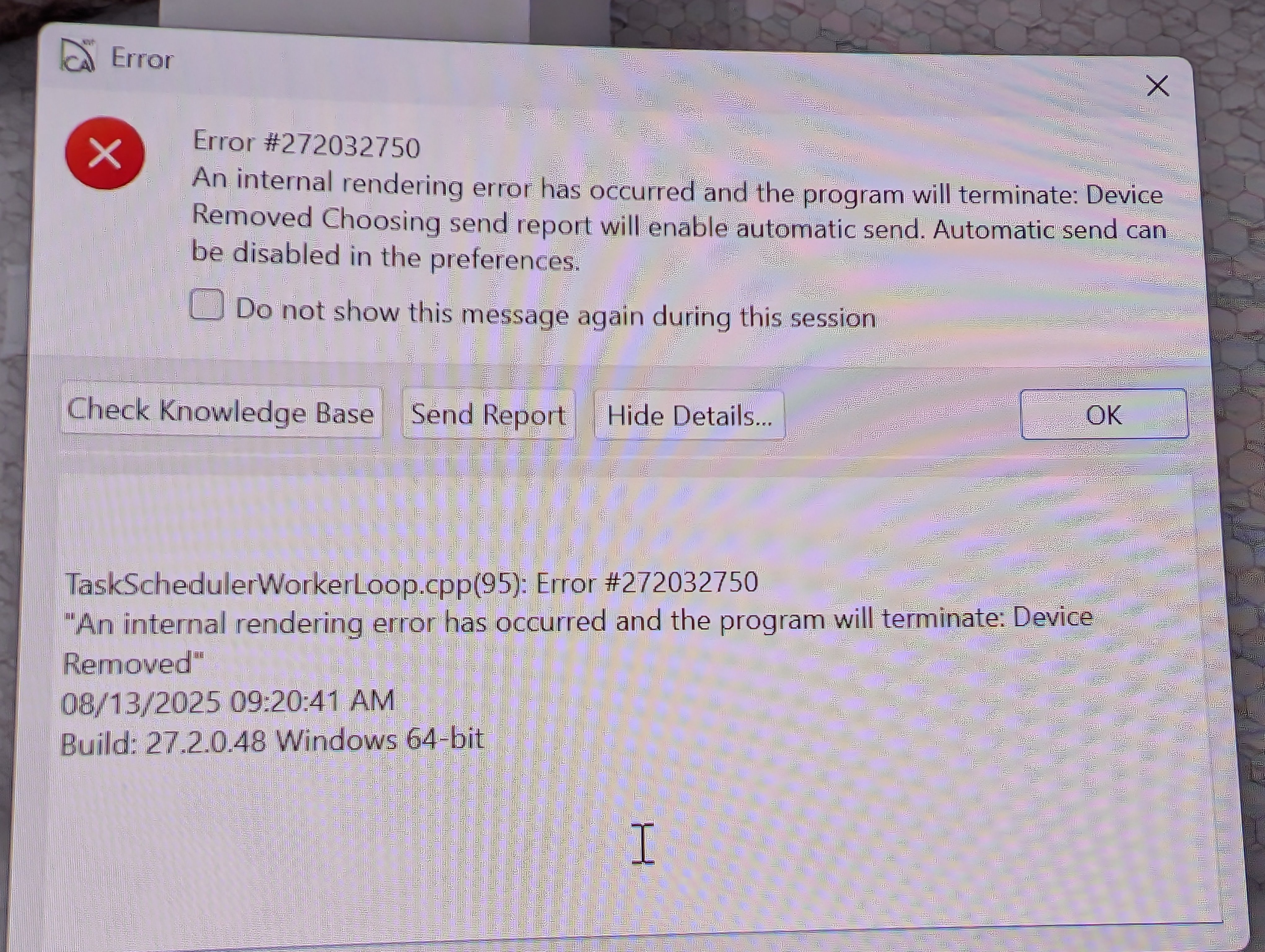

Ryan_M Posted August 13 Share Posted August 13 I've upgraded to a new PC. The hardware is fully capable of handling Ray tracing and path tracing. I have an Nvidia RTX 5080 GPU. In chief, when I select Ray tracing in the 3D rendering options I get the following error and the software force closes. I've read it could be a driver issue and to use the "studio driver" which I downloaded and installed. Does anyone have any fix for this issue? Link to comment Share on other sites More sharing options...
Solution Chief_QA Posted August 13 Solution Share Posted August 13 There is an issue with the latest Nvidia driver, a bug has been reported to Nviidia already, if you are using driver 580.xx then revert to the Studio Driver 577.00, that should clear up any driver issues you are seeing. 2 Link to comment Share on other sites More sharing options...
Ryan_M Posted August 13 Author Share Posted August 13 16 minutes ago, Chief_QA said: There is an issue with the latest Nvidia driver, a bug has been reported to Nviidia already, if you are using driver 580.xx then revert to the Studio Driver 577.00, that should clear up any driver issues you are seeing. Thank you! I'll give that a shot. 1 Link to comment Share on other sites More sharing options...
VeryDum-123 Posted November 26 Share Posted November 26 Installing the 577.00 Studio Driver cleaned up the crashing issue. Bart Sampson Link to comment Share on other sites More sharing options...
