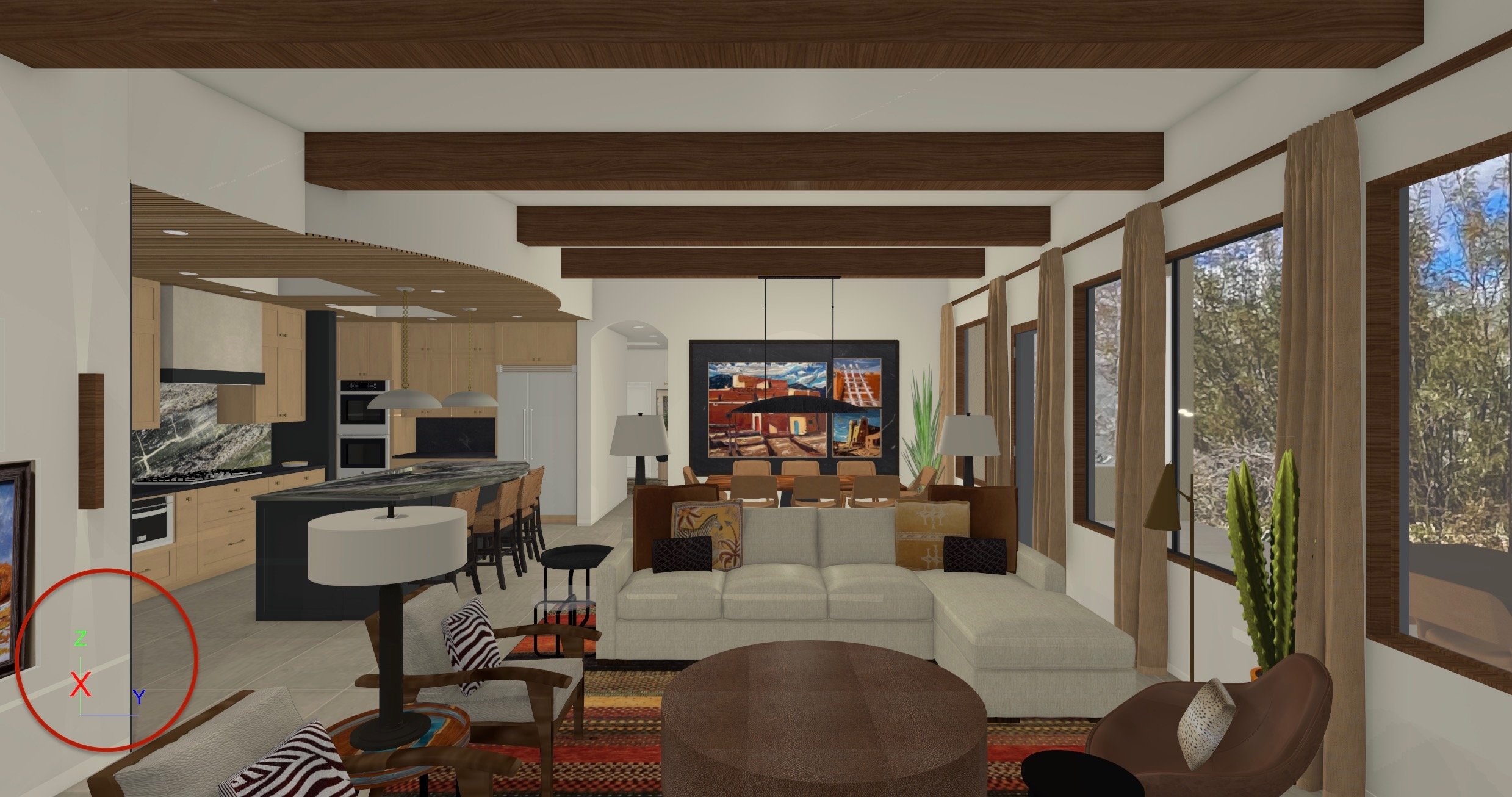

SuzLeigh Posted August 8 Share Posted August 8 Hi All, I'm using Chief16 pro. Several months ago, the User Coordinate Icon started showing up in all my 3D renders--circled in red in attached image. I'm sure I accidentally clicked a box at some time that turned this on, and now I don't know how to turn it off. Any ideas? Thanks in advance. Link to comment Share on other sites More sharing options...
ChiefTylerL Posted August 8 Share Posted August 8 Hello @SuzLeigh, These indicators can be controlled underneath of the View dropdown along the top of the screen. This one specifically can be controlled by going to View> Coordinate System Indicator - Floating and toggling it on/off. I hope this helps! 1 Link to comment Share on other sites More sharing options...
SuzLeigh Posted August 8 Author Share Posted August 8 Bravo!! Thanks so much ChiefTylerL Link to comment Share on other sites More sharing options...
