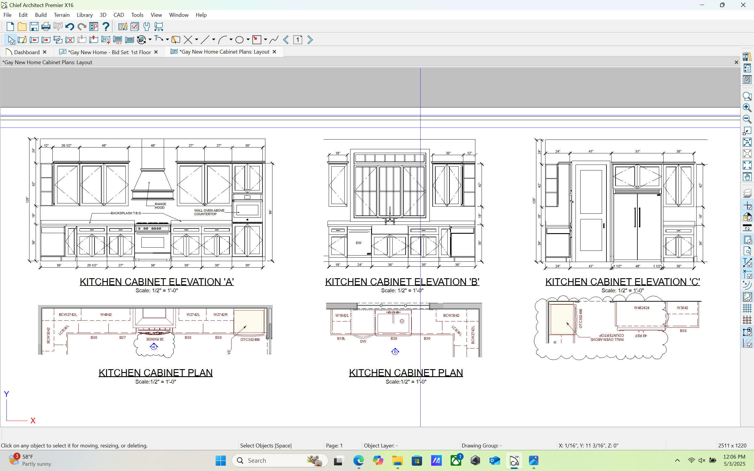

DB-Designs Posted May 3, 2025 Share Posted May 3, 2025 Hello Everyone! Is there a setting that I'm missing where the text can rotate within the layout boxes? I'm doing cabinet plans for a project and the text doesn't rotate as I rotate the layout out box so they all "read" in the same direction. The text in the callout arrow does not rotate either. I've attached a pic of what I'm talking about. Thanks in advance for your help!! Link to comment Share on other sites More sharing options...
PitMan71 Posted May 3, 2025 Share Posted May 3, 2025 Hey Don Click on those text objects and open the DBX (Dialog box), on the left side find options, Try unchecking OR checking the box "Rotate With Plan". Link to comment Share on other sites More sharing options...
