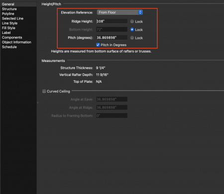

PitMan71 Posted April 8, 2025 Share Posted April 8, 2025 I don't mind at all. It's a bit tricky.....but easy once you know how. First I pulled it out from the edge into the room 4'-0", then In the edit DBX had to adjust the ridge height (This is the high side) and bottom height. The tricky part is you have to lock the parameter you have already set when making a change to the next parameter. If you don't do that you will be chasing it all over. BTW.... In this particular case make plan adjustments to the plane first and then open the DBX and adjust those parameters. Doing it out of order will not give you the outcome you are looking for. Side note: It seems that the ceiling plane tool is designed for vaulted ceilings that continue to rise at fixed pitch/angle. When used as designed you would want the ridge side of the ceiling plane to continue on that pitch and rise as you pull it away from the start point. Have a play around with the tool. You will see what I am referring to. Good luck. I hope this makes sense. Link to comment Share on other sites More sharing options...
