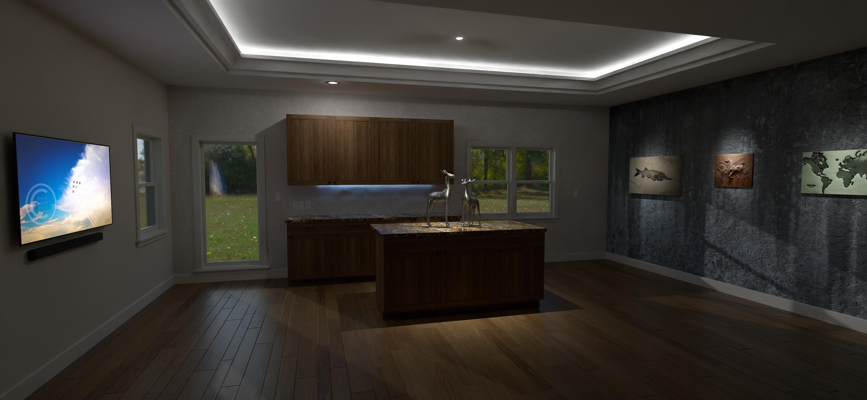

Hoff_Design 13 Posted yesterday at 04:33 AM There are a couple of additional considerations when adding lighting to your scene...In this render, I added a rope light under the cabinet and tinted it blue. I added a tray ceiling which has a built in rope light function. I added a TV on the wall and added one of my art prints to the screen, then selected the print and added emissivity in the properties panel of the the define materials dialogue box. I gave it a value of 100. In X17 these lights will contribute to the overall lighting in the room, as "area lights" In the next image I will turn off all the lights in the scene except for these three items so you can see the impact they have on the room. Link to comment
