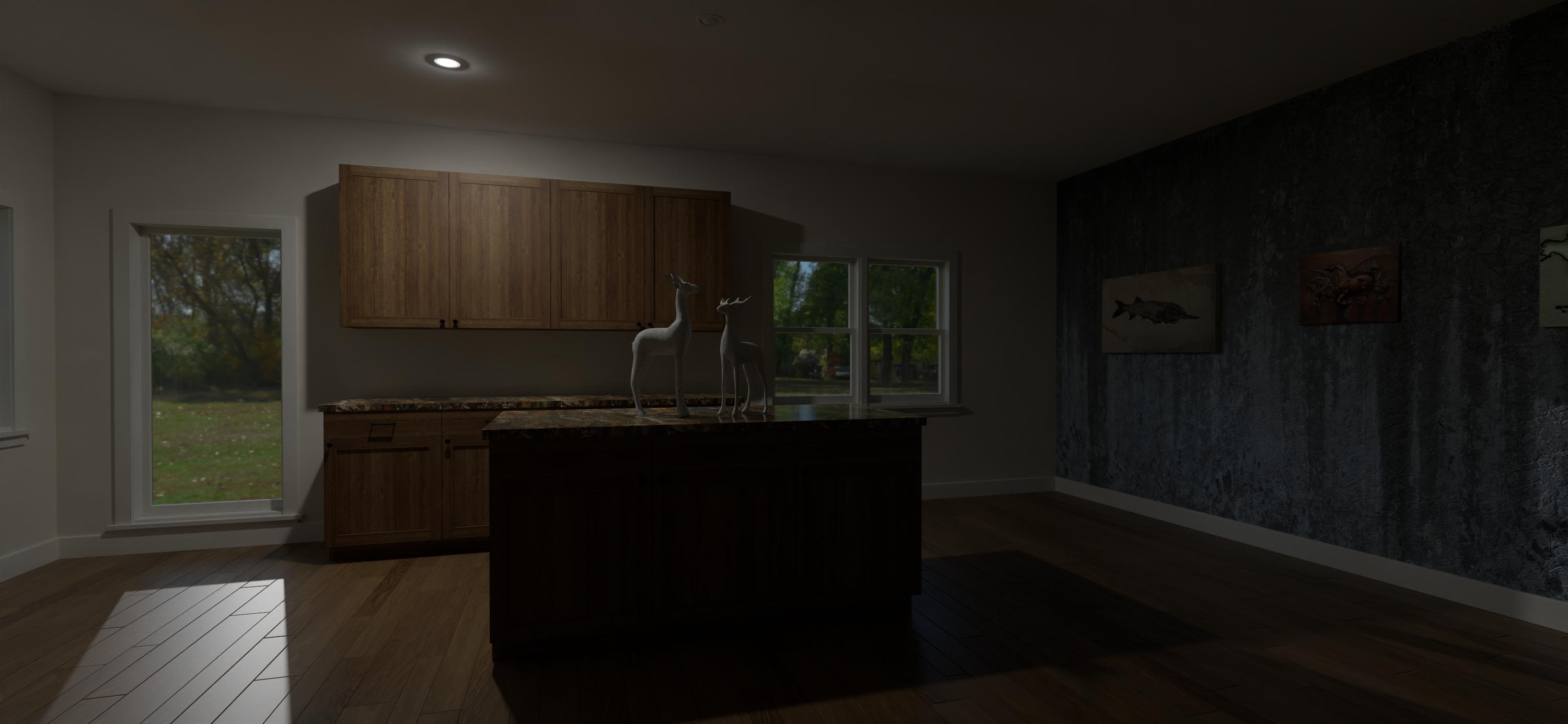

In this scene the 3 spot lights on the art wall are off.
The can light set as a spot above the deer is off.
The back can light set as a spot with area lights selected is on. (lighting the upper wall cabinets).
The daytime back drop intensity is set to 8.0
The sun is set to 8.0.
You can see how important correct light is in your scene. You can also see how just a setting of 8.0 for the backdrop and the sun impacts what shows up in your scene.
