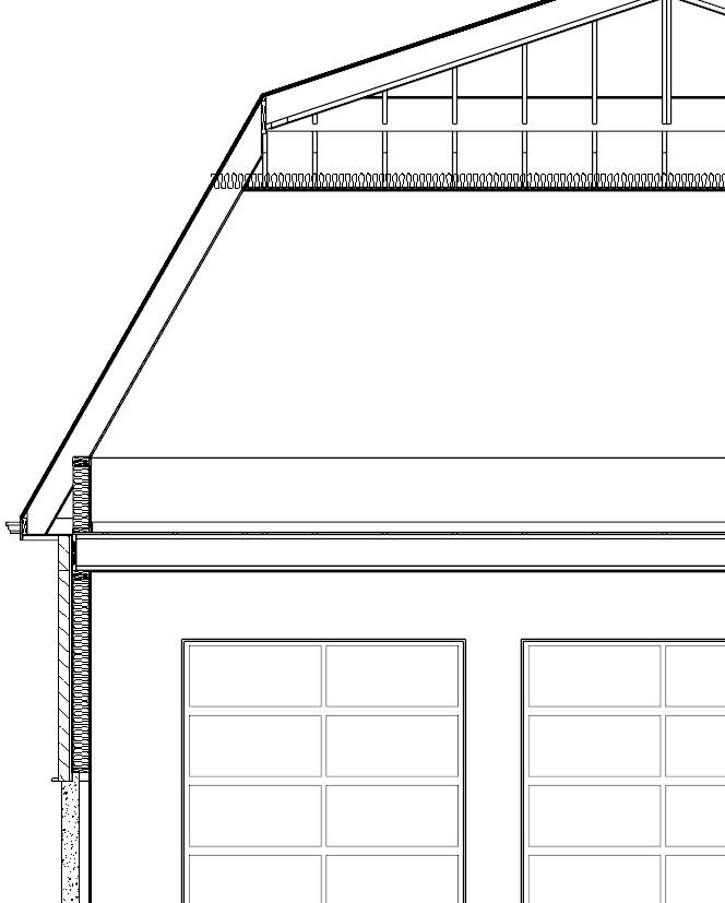

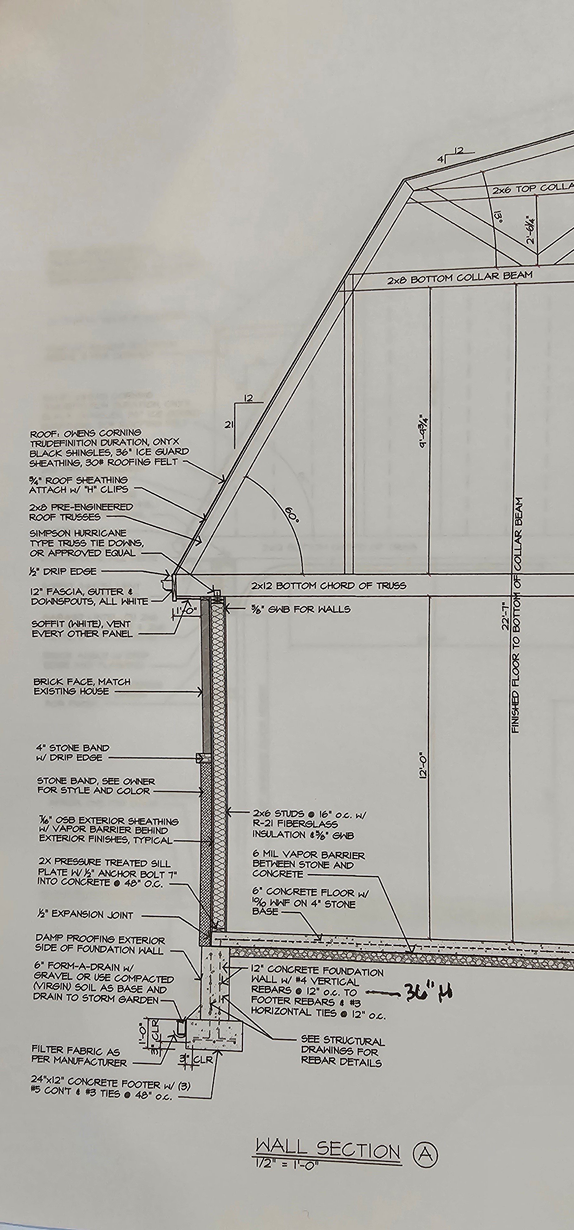

DznrDavid Posted February 12 Share Posted February 12 Hello All, I'm struggling with something that I'm sure has a simple solution that I'm just not figuring out. I need to create a cantilevered truss for a freestanding garage with a 4-way Gambrel roof. There will be a large storage area over the garage as well. I've watched every video I could find and did hours of digging, but can't seem to find the answer. I've watched the video dedicated to cantilevered trusses, but it's on an older version of CA and shows the option to control the birdsmouth when using trusses. In X16 that option isn't available. What am I missing? Attached are images of what we need to re-draw vs. where I'm at to this point. ** Plans were provided by the client who had them drawn by an architect who has since closed shop. Otherwise I just ask for the original CAD plans. Link to comment Share on other sites More sharing options...
