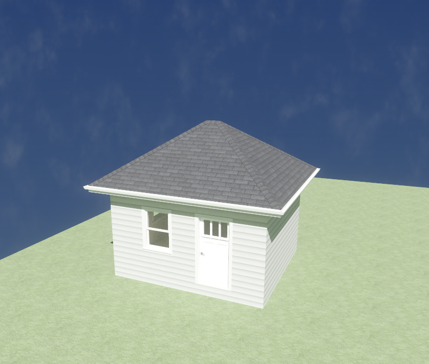

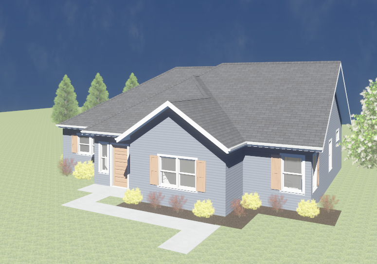

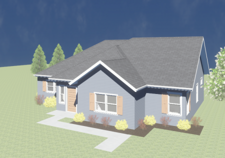

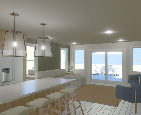

MariScheuber Posted October 21, 2025 Share Posted October 21, 2025 Hello, I am a student, and I've done projects before in Chief architect and came out beautiful, for some odd reason there is a lighting problem I'll insert images of what my place looks rendered, Id love some help to fix this! Link to comment Share on other sites More sharing options...

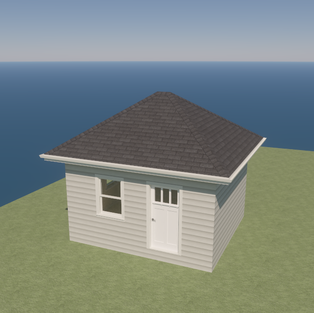

Chief_Trent Posted October 21, 2025 Share Posted October 21, 2025 Hi Mari, You may want to turn on "Use Generated Sky" in your camera backdrop settings. You can access that setting by selecting "Edit Active View" on the toolbar at the top of the screen to open the Full Camera Specification dialog. From there, go to the Backdrop panel and check "Use Generated Sky." Attached is an example of what that would look like (generated sky on the right). 1 Link to comment Share on other sites More sharing options...
