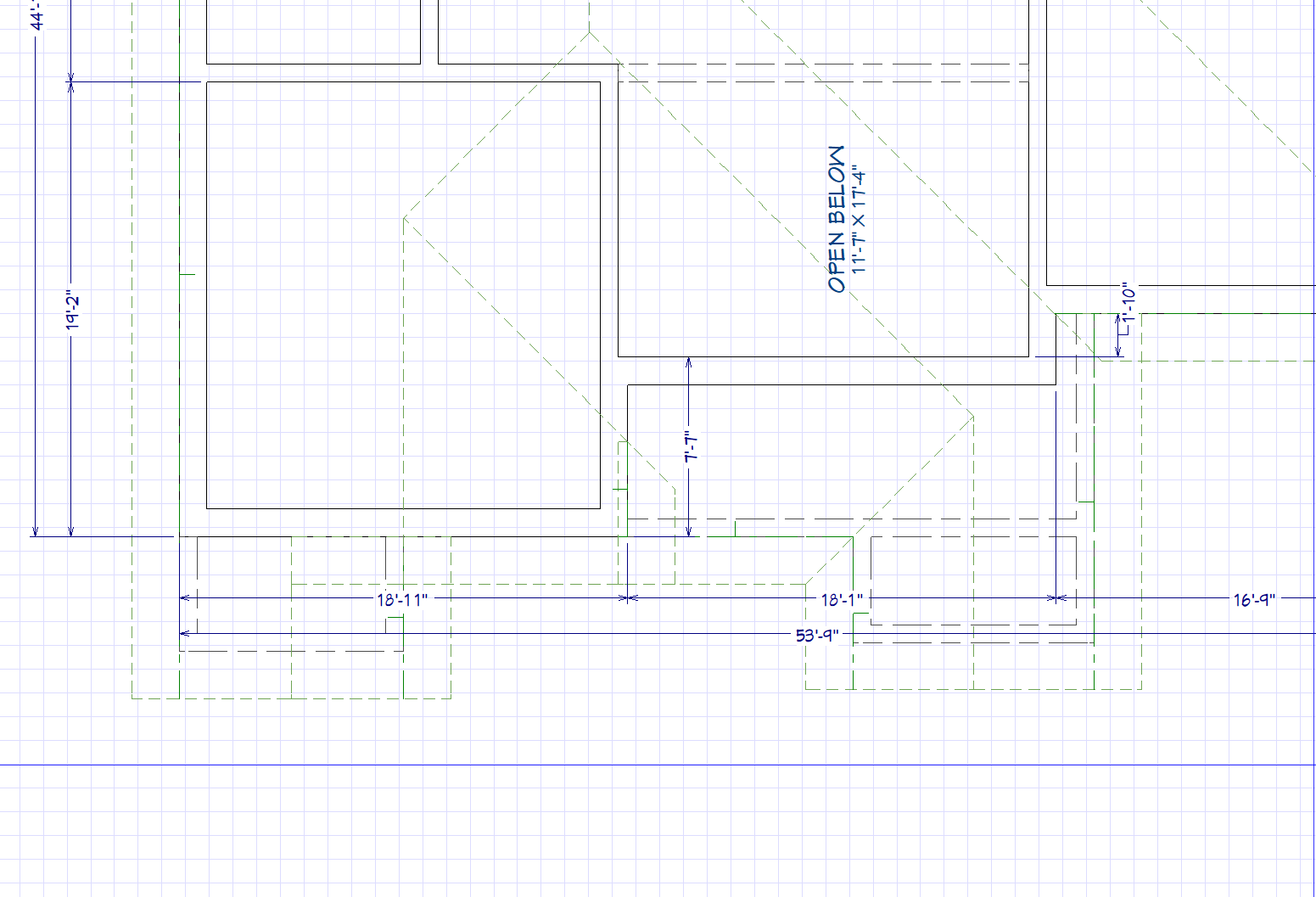

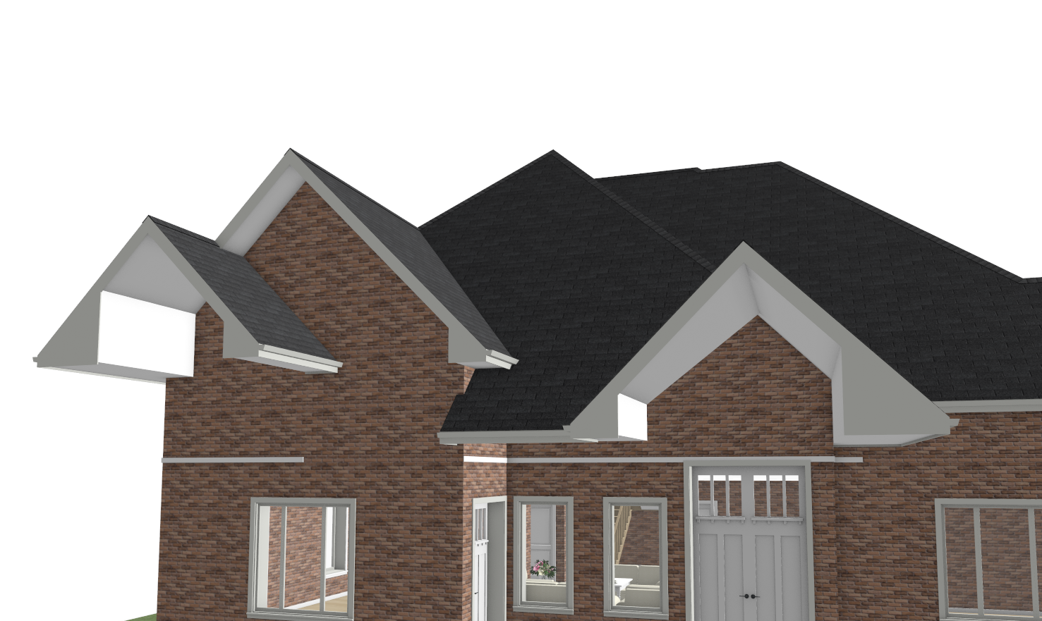

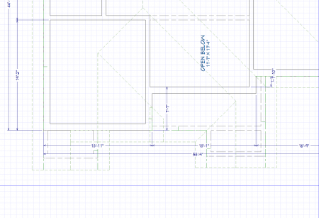

Jamsheediqbal Posted September 8, 2025 Share Posted September 8, 2025 I’m running into an issue with roof overhangs in Chief Architect. When I try to use a room divider to extend the roof, one side of the roof ends up with a larger overhang than the other side. I expected both sides to match, but the overhang seems inconsistent. Is there a specific setting I need to adjust (roof planes, baseline, or room definition) to make the overhangs equal? Or is there a better way to extend the roof without creating this uneven overhang problem? Any guidance would be appreciated! Link to comment Share on other sites More sharing options...
chiefjone9 Posted September 14, 2025 Share Posted September 14, 2025 (edited) It is necessary to check that the baselines of the sections concerned (Baseline Height) are aligned, by comparing and manually adjusting their heights if necessary. Tutuapp Edited January 5 by chiefjone9 Link to comment Share on other sites More sharing options...
