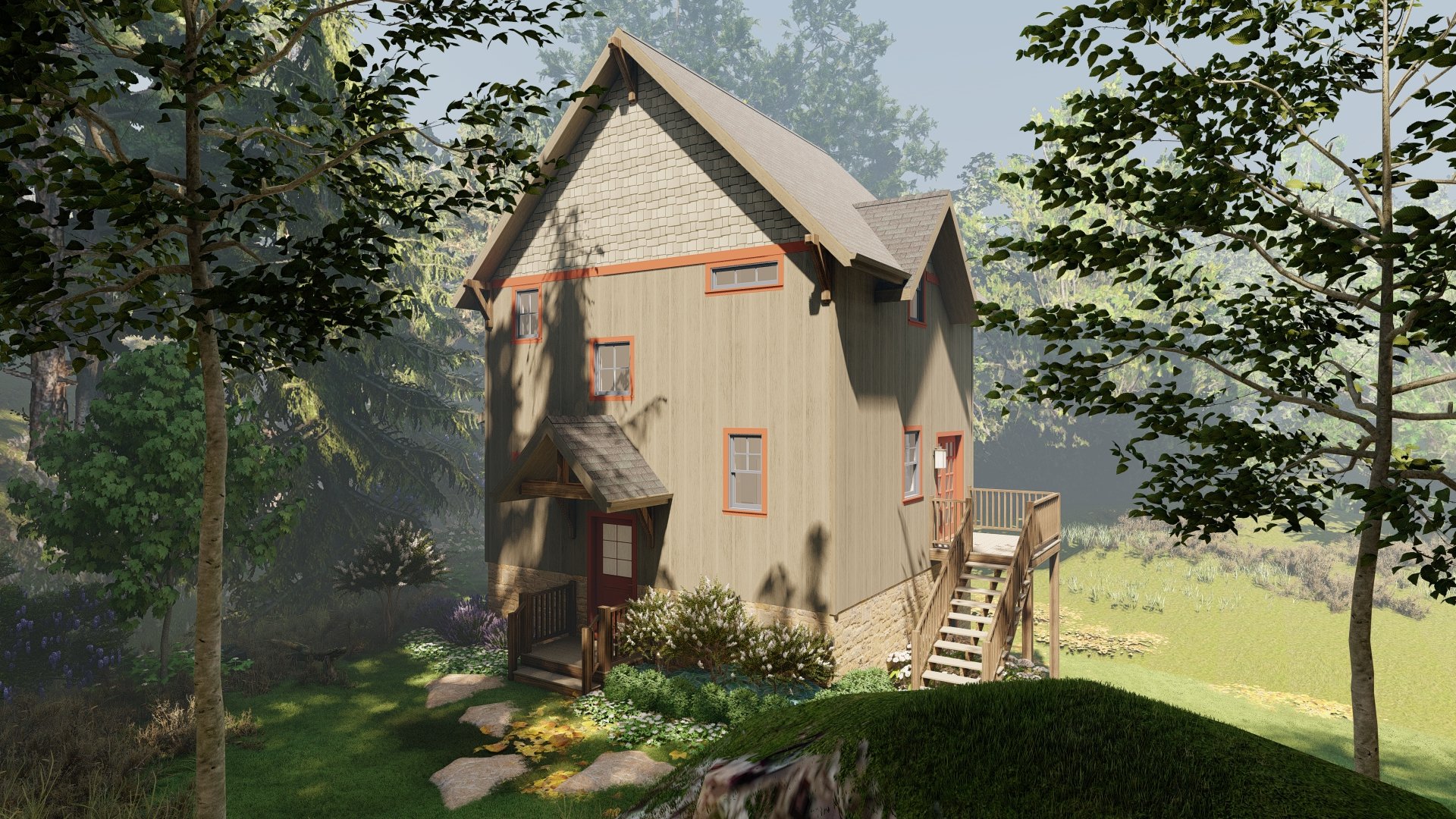

  6. Here's the .plan file. (my apologies for not sharing this initially). I've tried all the normal auto-roof work-arounds (and default or specific wall settings, as well as roof gable lines) that I know but can't seem to make this simple roof type render correct For context: I do conceptual design with the builder/client looking over my shoulder vie Zoom and as such, I fight really hard to keep auto-roof settings on (as well as auto deck framing, etc...). Some projects we advise the client to overlook small rendering discrepancies to allow us to chow them options quickly via auto-settings being on. This may be case for this one as well, but it looked so simple to me that I was sure there'd be a quick way to direct the software to reduce the gable overhang and box the eave overhang.... Job-3225 Pat and Sid Johnson - AUTO.zip
  7. Yeah...I went that direction initially, but the gable overhang will not reduce. The house end wall is broken to achieve the front gable portion (in the distance). It seems that the wall break will not allow the gable wall to reduce the overhang with auto settings for some reason.
  8. Is there a way to achieve the reduced gable overhang as shown in the actual photo...with auto-roof settings on? Marshall X16
