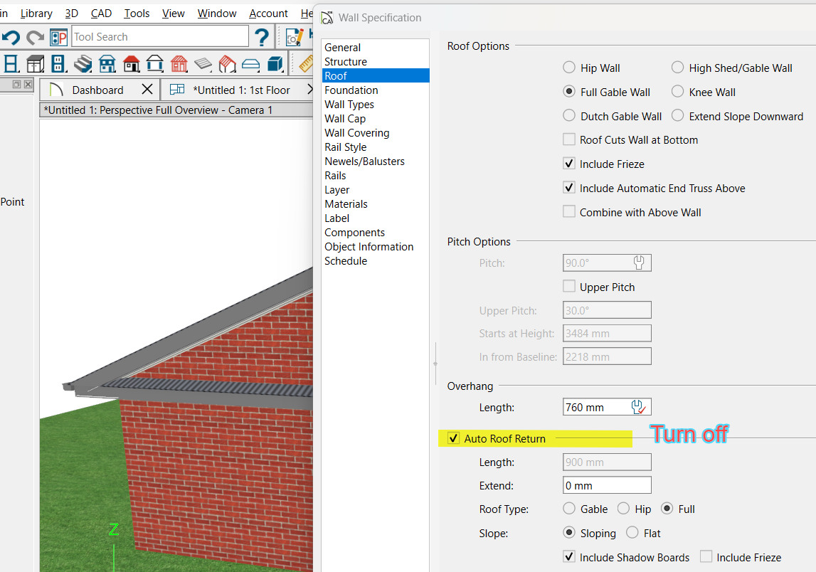

SHCanada2 Posted September 25 Share Posted September 25 Screen Recording 2026-09-25 000617.mp4 I can get rid of it by changing the eave width, but of course tha is not what I what. I also noticed the green right angle lines at the corner. I tried tab through to catch something else, and even turned all layers off excet roof planes, baselines, to ensure there was not another roof, but if I can change this roof and it comes and goes, i figure it must be related to this roof Link to comment Share on other sites More sharing options...
Solution Mark3D Posted September 25 Solution Share Posted September 25 If i understand you turn off auto roof return 1 Link to comment Share on other sites More sharing options...
SHCanada2 Posted September 25 Author Share Posted September 25 that was it, i was looking for it in roofs given it was a manual roof, but it is as you show in walls merci buckets Link to comment Share on other sites More sharing options...
