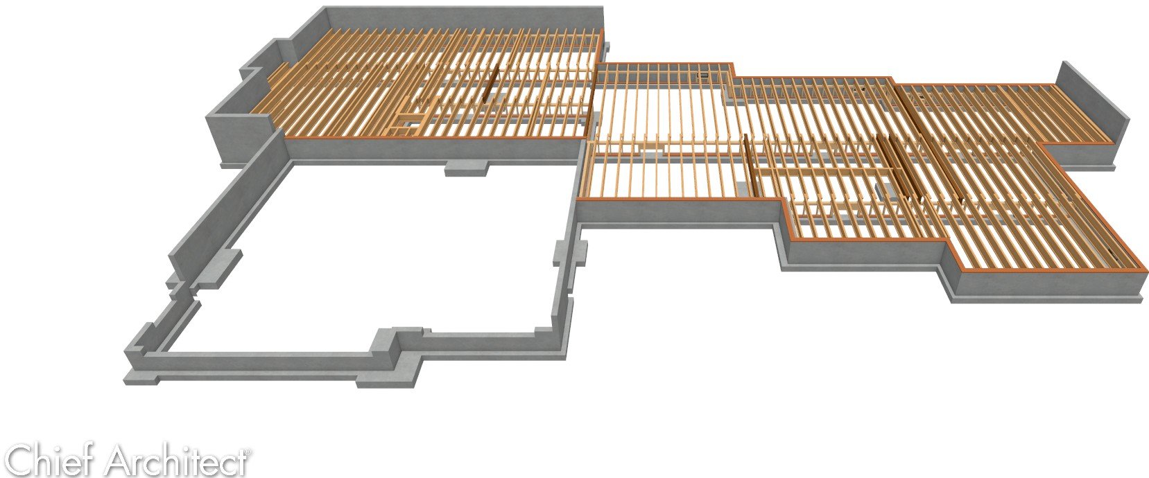

WadeDesignNC Posted Tuesday at 09:06 PM Share Posted Tuesday at 09:06 PM Trying to show a perspective framing view and I can not get the first floor framing to display. It will only show the siding and the drywall not the actual framing members. I have the 2x6 layer set as the main/framing layer Link to comment Share on other sites More sharing options...
scottharris Posted Wednesday at 12:53 PM Share Posted Wednesday at 12:53 PM One the foundation floor, use the perspective floor overview camera; then change the layer set to '3D Framing'; turn on the layer "Walls, Foundation". Link to comment Share on other sites More sharing options...
