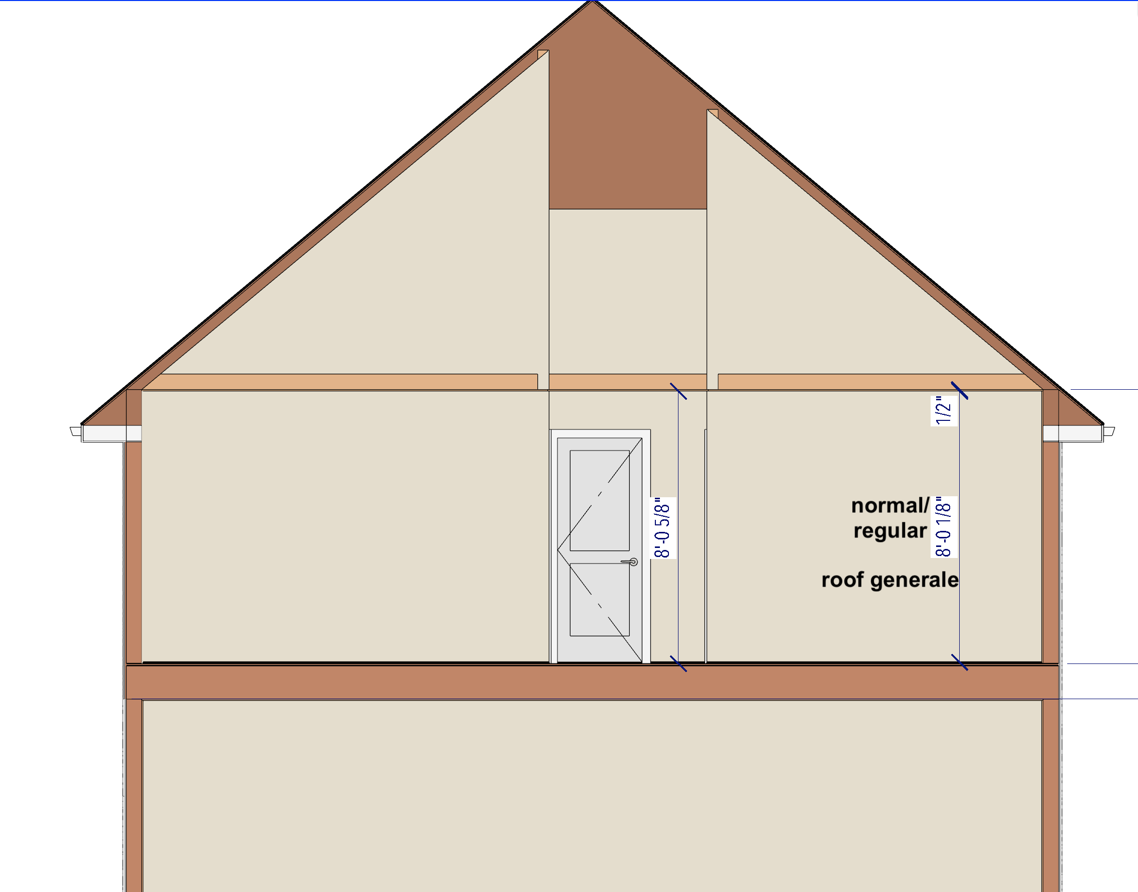

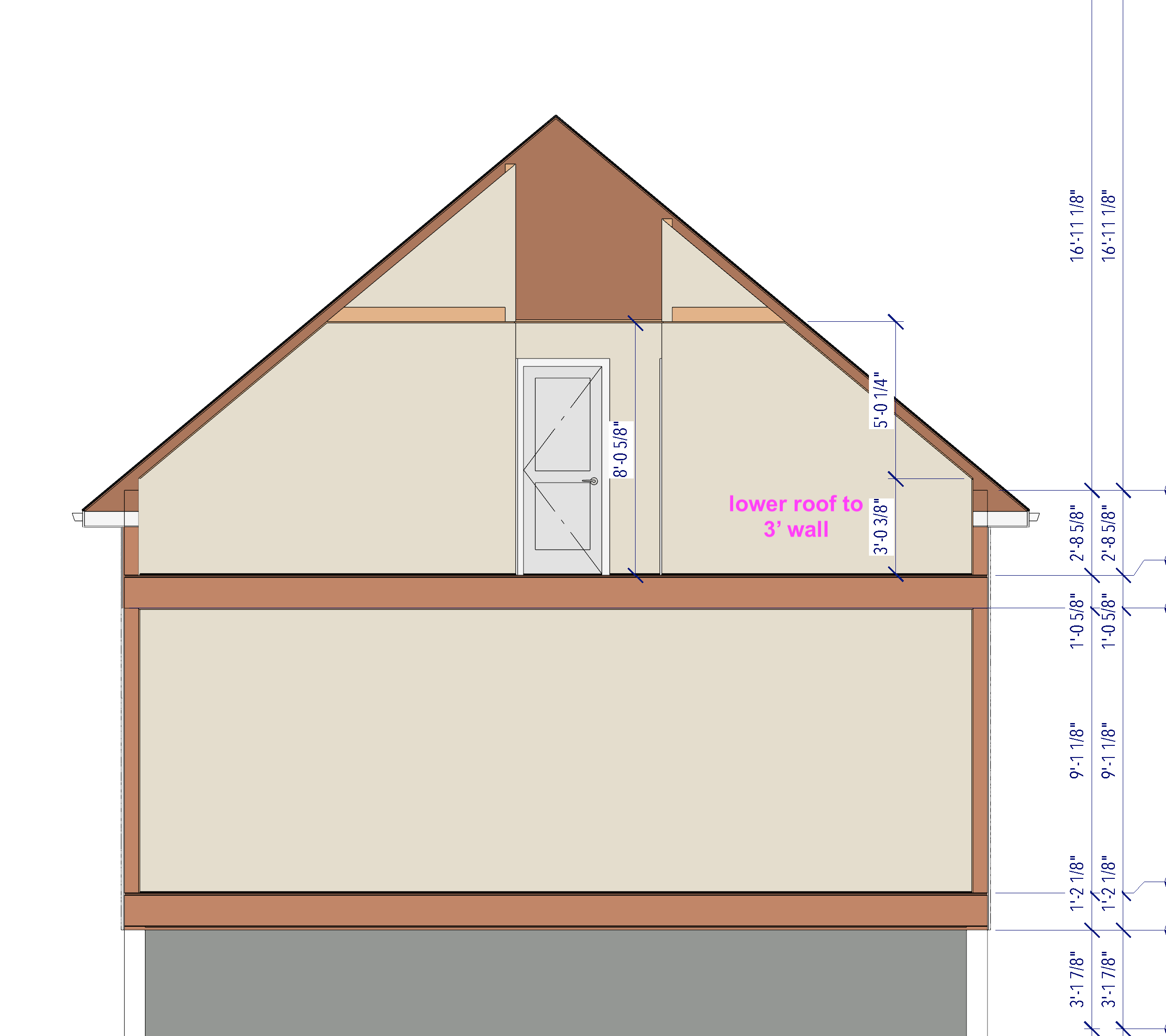

buzzsaw204 Posted September 1 Share Posted September 1 Hello, Normally, when I generate the roof, it's set to the wall height, 8'-0" What is the setting for me to lower my roof when I use the auto generate Roof. I would like to lower my roof 36 inches when Auto generating the Roof to create this style. TIA Link to comment Share on other sites More sharing options...

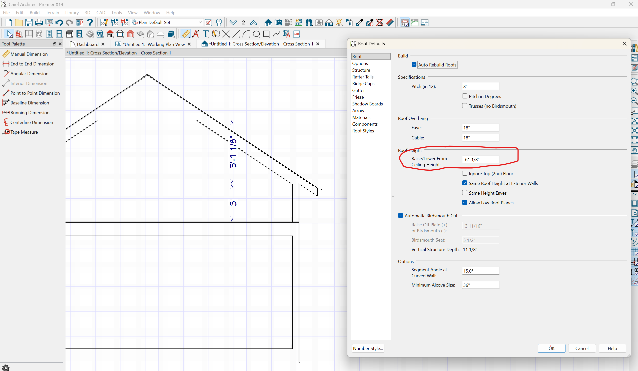

Solution Garybills Posted September 1 Solution Share Posted September 1 Here are the settings for lowering the roof with auto roofs if this is what you are looking for. 1 Link to comment Share on other sites More sharing options...
