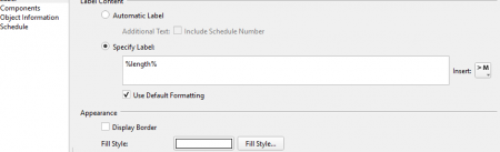

paulsullins Posted August 27 Share Posted August 27 Team, I have using CA for 20 + years and now trying to widen my skills. I provide a framing takeoff for our framers and it would be helpful to change the lable to ft/in. I think it is a formula in Macro. YT-Canary 1889 GL Lumber.caproj Link to comment Share on other sites More sharing options...

paulsullins Posted August 27 Author Share Posted August 27 Joe, Look at My file. I want inches on each rafter to be in feet and inches length 336"= 30"-6" Link to comment Share on other sites More sharing options...

paulsullins Posted August 27 Author Share Posted August 27 The only Macro I need for is to really round it up to the nearest foot for the framers. Link to comment Share on other sites More sharing options...

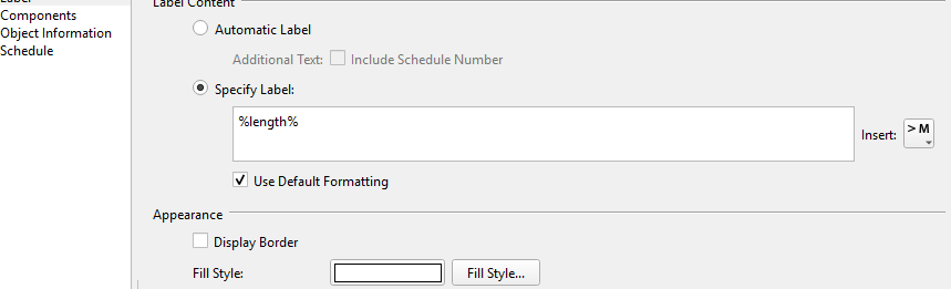

paulsullins Posted August 27 Author Share Posted August 27 Link to comment Share on other sites More sharing options...
DBCooper Posted August 27 Share Posted August 27 If you want it to the nearest inch, you can use "%length.round()%". if you want it to the nearest foot, you can use "%length.to_ft.round()%". If you want it shown in feet and inches but rounded to the nearest inch, you can use "%length.round().to_s("'-\"")%". 1 Link to comment Share on other sites More sharing options...
Joe_Carrick Posted August 27 Share Posted August 27 (edited) 3 hours ago, paulsullins said: The only Macro I need for is to really round it up to the nearest foot for the framers. %length.to_ft.ceil%' but you really should tell them what size & type members: I-Joists - size and # Lumber - nominal size, material, pressure treated Steel Channels etc That's all automatic with my macros. It even indicates if they need to be "PT" (pressure treated). Edited August 27 by Joe_Carrick Link to comment Share on other sites More sharing options...

DBCooper Posted August 27 Share Posted August 27 I like Joe's suggestion of using "ceil" instead of "round" since I believe this will always round up instead of rounding down when you are less than 1/2 a unit. Wouldn't want your framers to cut things off too short. Link to comment Share on other sites More sharing options...
