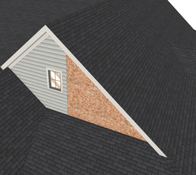

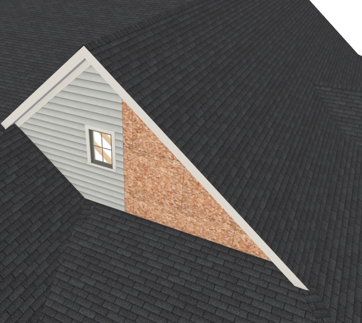

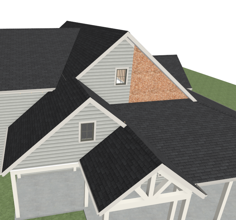

GeneDavis Posted August 21 Share Posted August 21 I had it and fiddled with the wall spec and this happened. It is not the roof that is doing this. The part that is good sits atop a first floor exterior wall, and the part with the problem bears on a carry beam, no wall underneath. I'm quite sure it's not the roof cutting away the finish. File attached. Why the siding stripoff.zip Link to comment Share on other sites More sharing options...

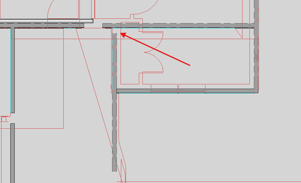

robdyck Posted August 22 Share Posted August 22 Pull this wall away from that gable end wall and the siding rebuilds. Link to comment Share on other sites More sharing options...
