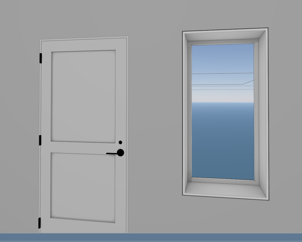

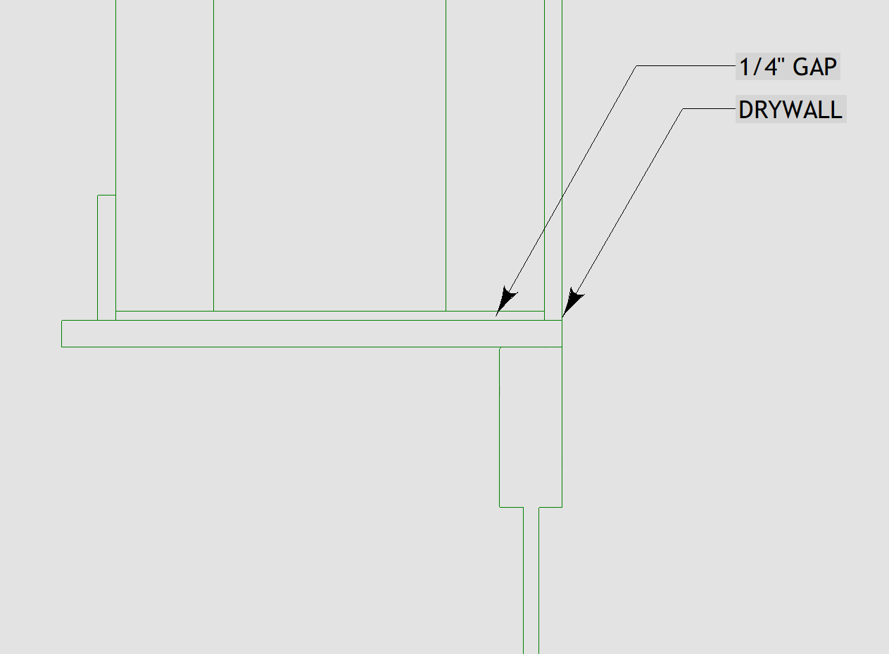

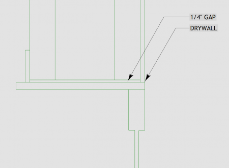

robdyck Posted August 19 Share Posted August 19 Not sure if you mean 1/4" overall or 1/4" each side, but either way, Chief models those correctly for me, but only for windows. Drywall is directly up against the door jamb regardless of the rough opening. DOORS: Link to comment Share on other sites More sharing options...
