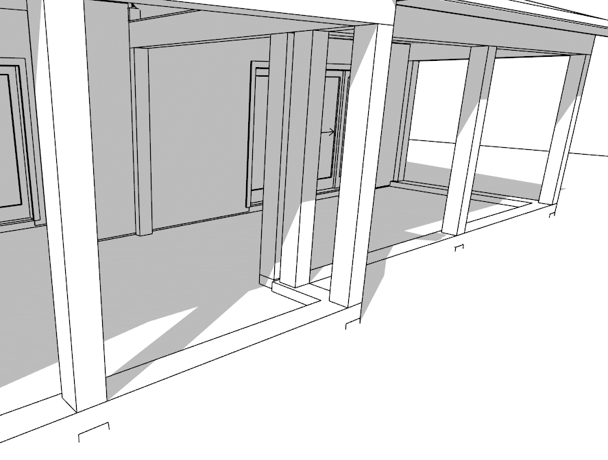

GeneDavis Posted August 14 Share Posted August 14 I did this post-facto and have now to deal with dropping the foundation wall top. Where is this done? I open the foundation "wall" for spec, and see no way. Link to comment Share on other sites More sharing options...

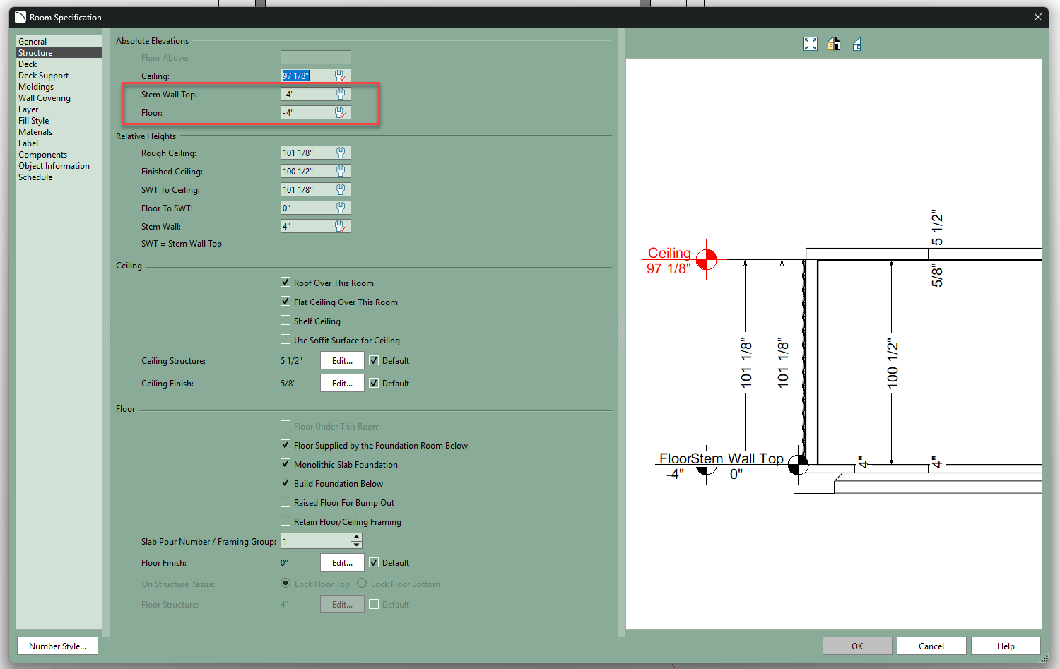

Solution tundra_dweller Posted August 14 Solution Share Posted August 14 @GeneDavis Gene, open up the room dbx for the porch and adjust the stem wall top to match the floor elevation. 1 1 Link to comment Share on other sites More sharing options...
